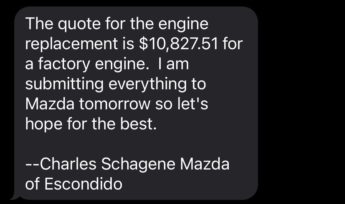

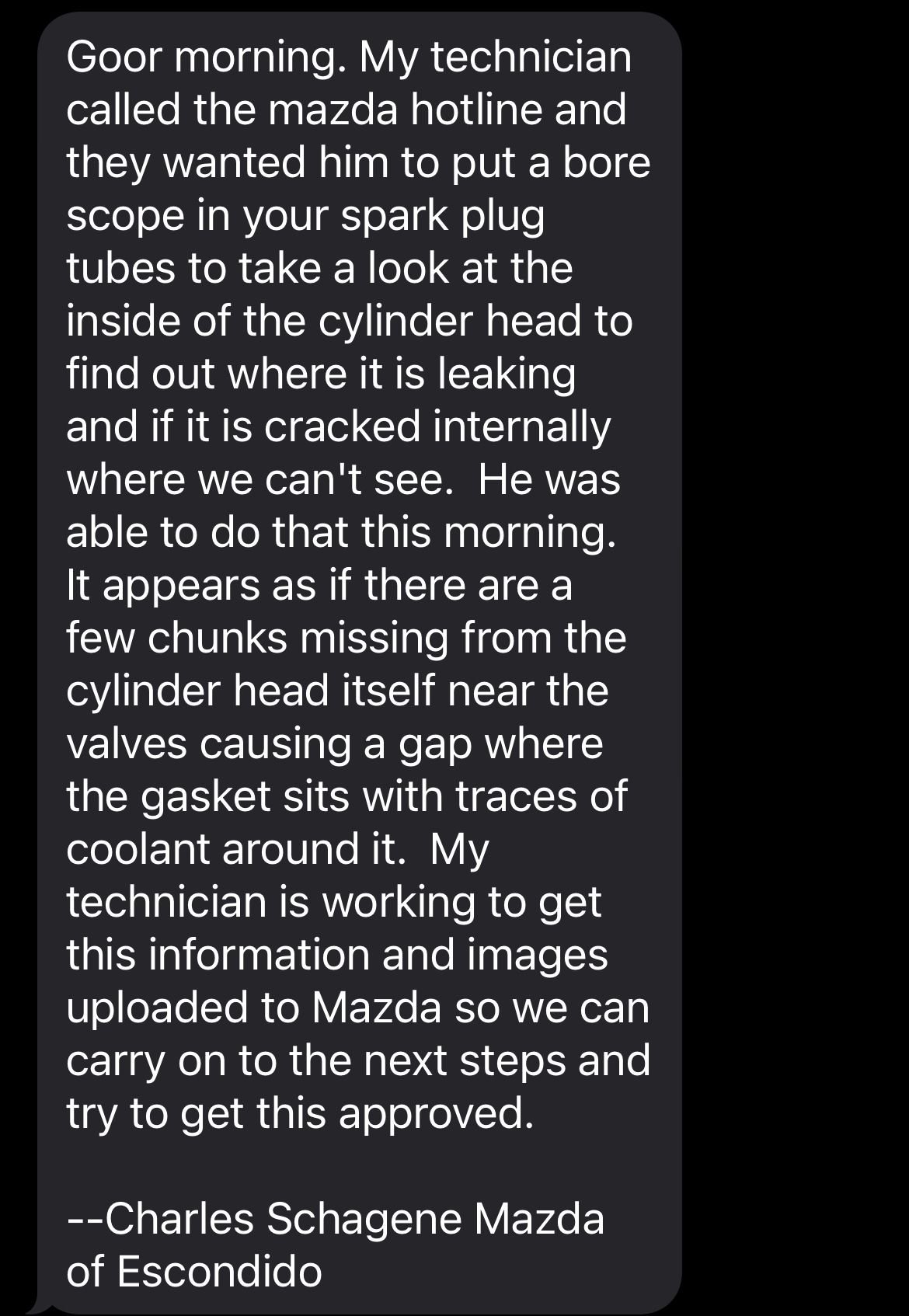

Originally Posted by nalcorn
Hi All -
Found this thread amongst others with this coolant leak issue. So disappointing to say the least. I own a 2016 with 110k miles. I can understand a few "bad apples" in the bunch in terms of our 2016+ CX-9s. Love this car and meticulously maintained it. My coolant leak was nothing visible, meaning no dried splash spots or liquid on the floor. First thing I noticed was rough idling intermittently and occasionally the engine would die (only at stops). Then a few days later, got a Engine Hot notification. Mind you, never got a check engine light. Pulled over right away and observed my coolant reservoir was completely empty. I happen to have 2 new bottles of FL22 coolant as I was literally going to do a coolant flush soon. I almost had to use the two bottles to fill it back up.
Out of concern, I took it to my buddy's car repair shop. He did a pressure test and stated there is no external leak, but I am losing pressure hence the coolant is leaking somewhere internally. I also noticed by exhaust has a funny smell and blows white especially on cold starts. His thought was maybe the turbo was cracked somewhere and the coolant was burning through the exhaust or crack in the head. From reading various post, even from other Mazda forums, it seems to be a cracked head.
I am thinking of giving the dealer a call tomorrow, to see what options I have. Sounds like a new motor is needed ugh. I am definitely out of warranty, but if there is a technical bulletin number out there please share. I will update with my progress as I get them. Hopefully my story can help others. When my mechanic friend said to search forums, I admit I was doubtful there would be known issue like this especially from Mazda and supposedly not sharing any Ford parts. Another option I pondered, depending on the cost to replace the engine, would be to sell the car to Carmax or similar online sellers and wait for the CX-90. TIA
Okay, updating my post and process to get my motor replaced. As I mentioned previously, my car was way past it's warranty but the service guy at my local Mazda dealership (Escondido, CA) went to bat for me. He had his master technician confirm the issue noted in the TSB mentioned by @PTguy (MC-10215280-0001.pdf).
The total cost to replace the engine (top and bottom) was $10,827.51.
Luckily, Mazda only asked me to cover $1,000 of it. It took roughly 20 days from time of approval to completion of engine replacement. I wasn't particularly looking forward to getting into a new car especially in the current car market. So brand new engine, but only a 12K mile warranty. I do want to note that my original Turbo was re-used which makes sense. I think it makes a difference on the service advisor at least from what I have read on various forums. Good luck to anyone who encountered this unfortunate design flaw.
