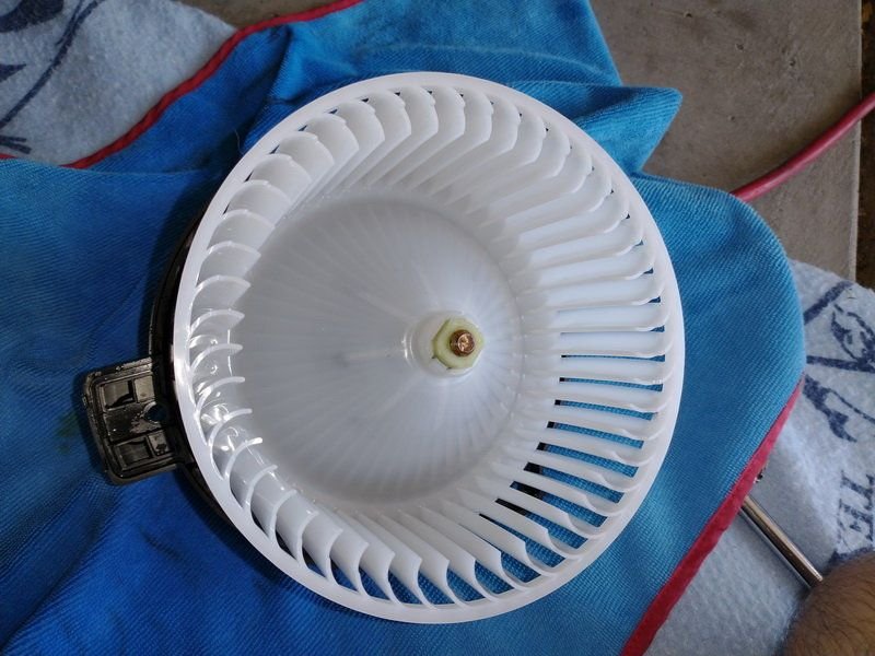

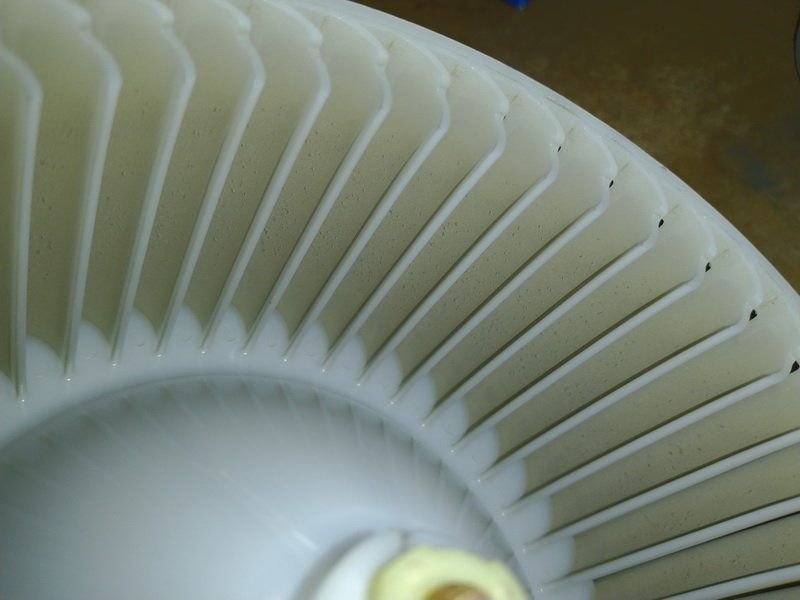

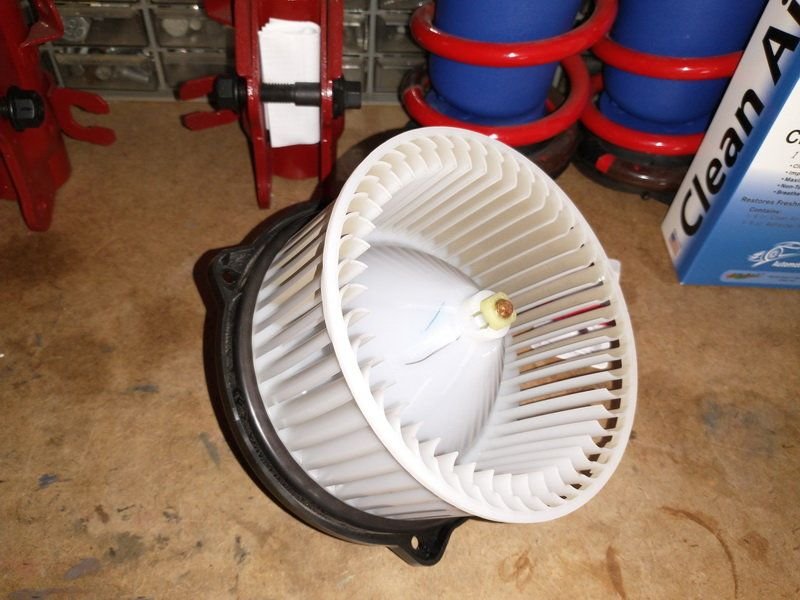

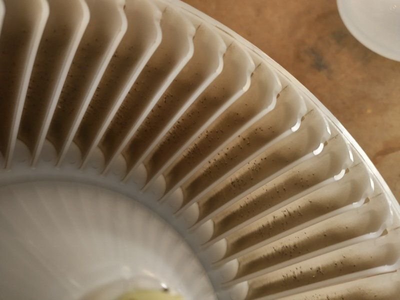

I don't really want to get onto a debate about cabin filters because unless people actually try several brand for testing it is all subjective. I can say during the extreme fires in Northern CA we offered free labor to change cabin filters. I had my tech and mechanic make a post it of the cabin filters removed. It was a curiosity to see which filters caught the ash. Ash from most fire is not only flacked but pasty. I was surprised that also most all the cabin filters caught a lot of the ash on the intake side but was surprised that many had ash coming through the filter. Even on HEPA and Carbon released cabin filters. I started to have the guy do a casual wipe of the area inside the the vent just past where the cabin filter is located to show the customers.
I stated I change or* clean (if using *K&N) my cabin air filter often and for the first few times I used OEM cabin filters the first year . This was my blower motor and showed how much got past the filtering element before I caught it and stopped using OEM cabin filters
