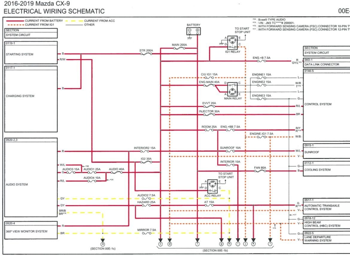

Meter connected in series: 1.9a draw (after sitting for 30+ minutes).
---> Removing Fuse10 (Interior Box), 15a: drops to .01a (after ~45seconds).
Looking for advice on next steps. Connects to the audio system, not finding any tsb related.
Edit: thinking you misread my original maybe. Fuse is #10, 15a fuse.
thanks for the reply. Per this wiring diagram I’m only seeing audio system, which aux plug are you referring to? Other than a USB Plug in for her phone, she shouldn’t have anything.
Yes I did.
The info I referred was for fuse 15. So the Aux port/connector does not apply.
Fuse #10
Depending on the sound system? Is it Bose or other?
