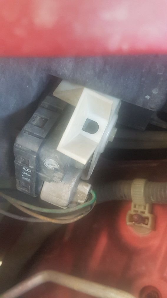

Hi,
Maxda CX-7 from 2008 with xenon. (2.3 DISI turbo, AWD)
I have changed the xenon bulbs and I have removed the assembly both part, because I needed to change the ballast too at a part, I have removed the fender side part for this.
Now the low beams projects to much to the side part and not to the road, so I need an andjustent ( for low beams ) of INWARD, otherwise it is useless in the night my Mazda cx-7
Here you can adjust to up-down, but not this I need:
Any help? - beside "is not possible" , because for sure it is, since before I worked there It was usefully.
Old Aug 1, 2020 | 05:40 AM
There is up& down adjuster, and another adjuster for left & right. It maybe obscured by the framework/front guard.
