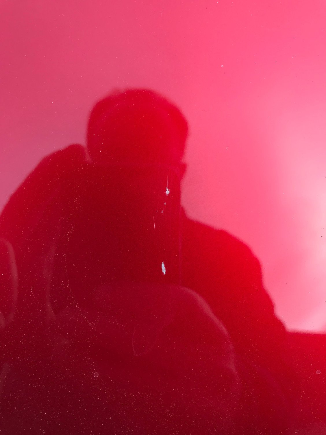

I just took my 2018 Mazda 6 which has soul red to the dealer yesterday. They said they're going to take it to the body shop and get an estimate for a complete respray as my hood, side fenders have multiple chips. I'm concerned they won't match it 100%, also how can they prevent this from happening again. Once they take pics and send the estimate to my dealer, they will reach out to Mazda and see what they say. Not really sure if I want a complete respray or not. But there really is no way to fix this. Other than have the respray done by Mazda themselves and put ceramic coating on the vehicle.
