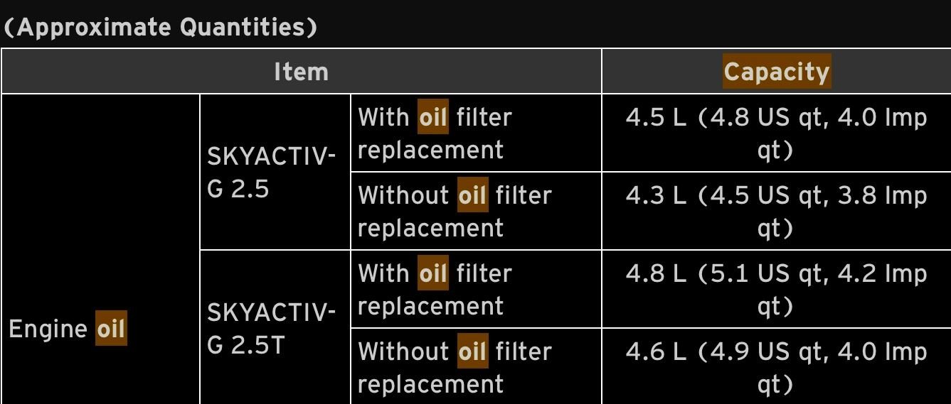

Honestly while that is a repeated document from Mazda often posted on this forum and many others, I am just asking .... did you read the *top portion ? For all the oil changes we do in the shop (minimum 9 a week) I have seldom had any of my Techs say that when they read the oil quantities on many platforms that they are spot on.
The wording :
* (Approximate Quantities)
Now if you all want a real good laugh pop over to another popular Mazda forum and watch the DIY argue down about the "exact amount" posting that document and no one seems to actually read that valuable information?
On a technical note: The reason the Mazda Turbocharged engine has a slightly more oil quantity is for the cooling line that go to the Turbo itself.
The wording :
