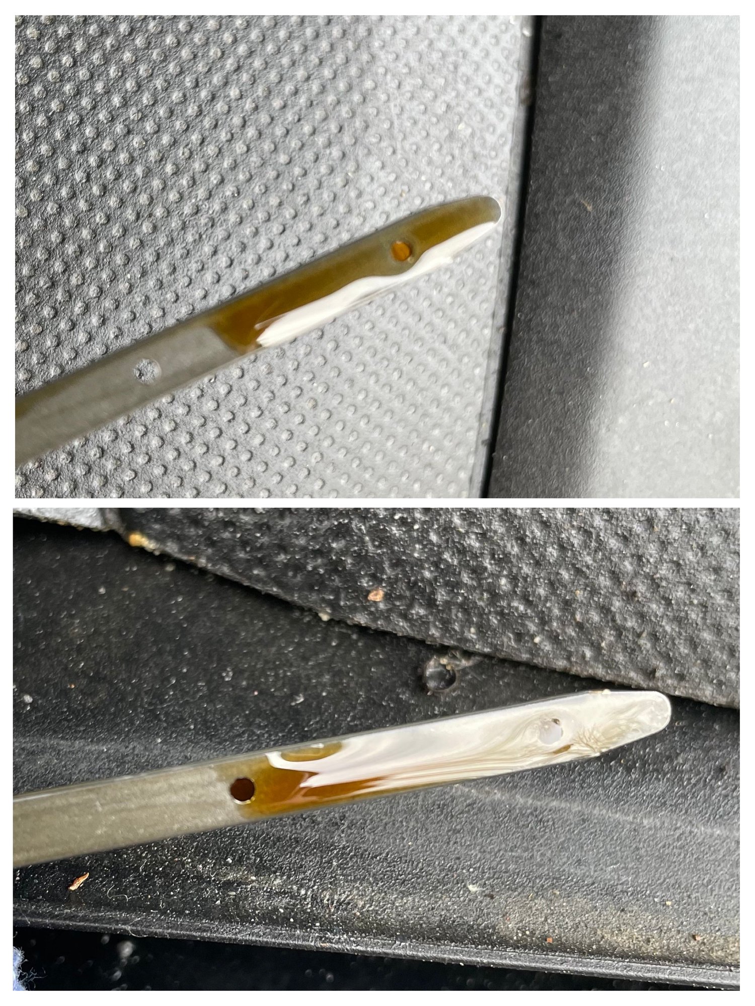

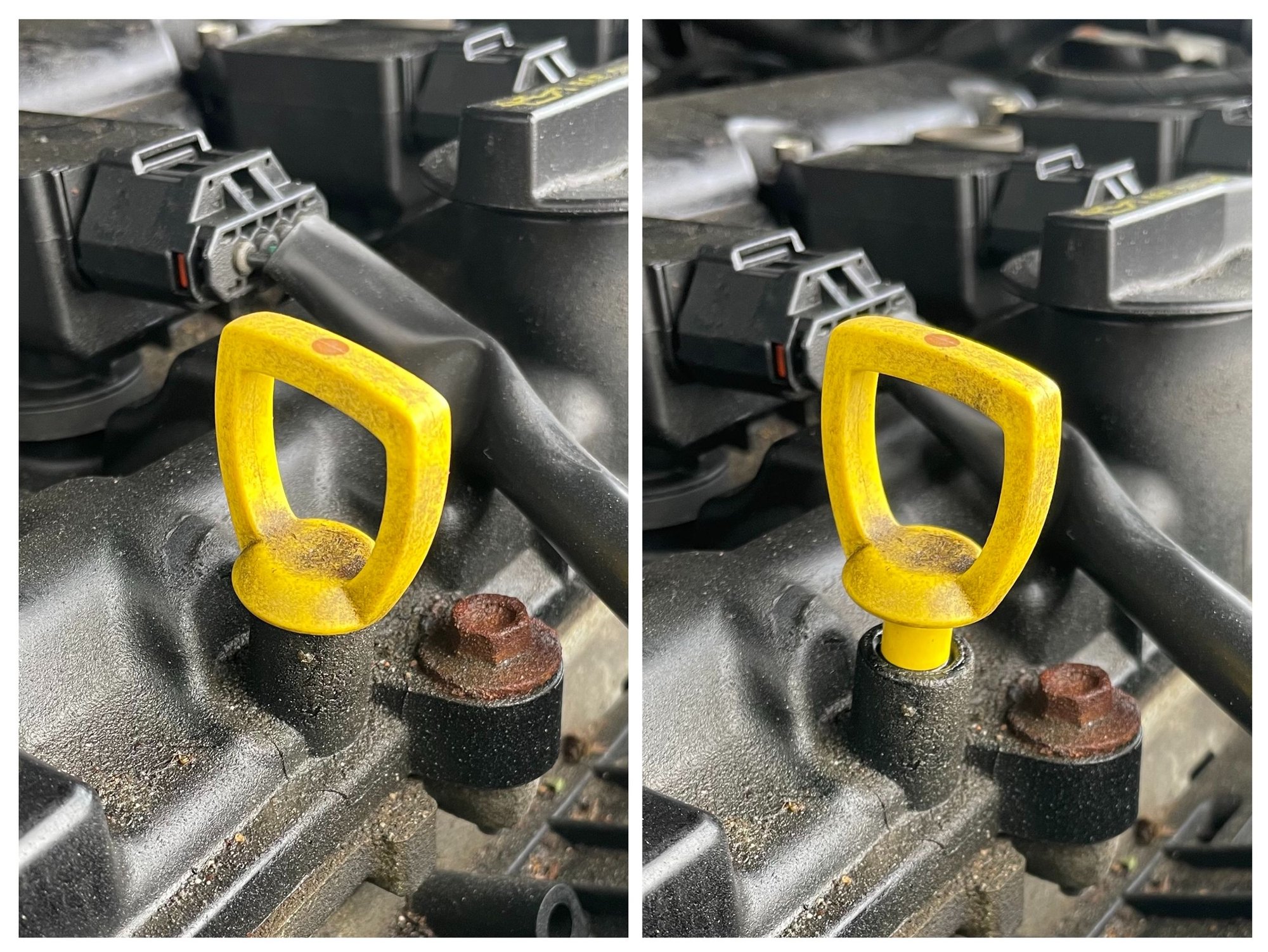

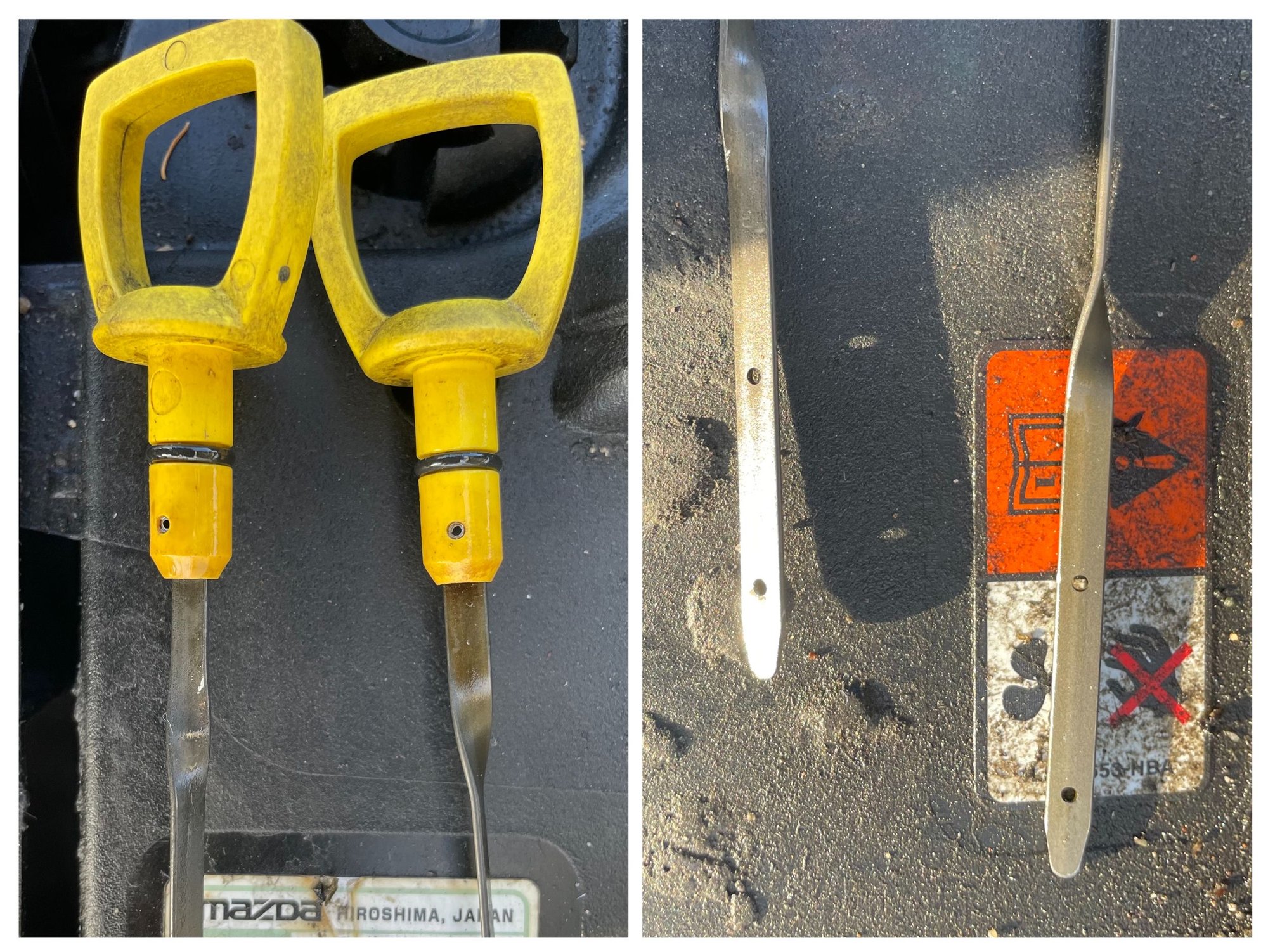

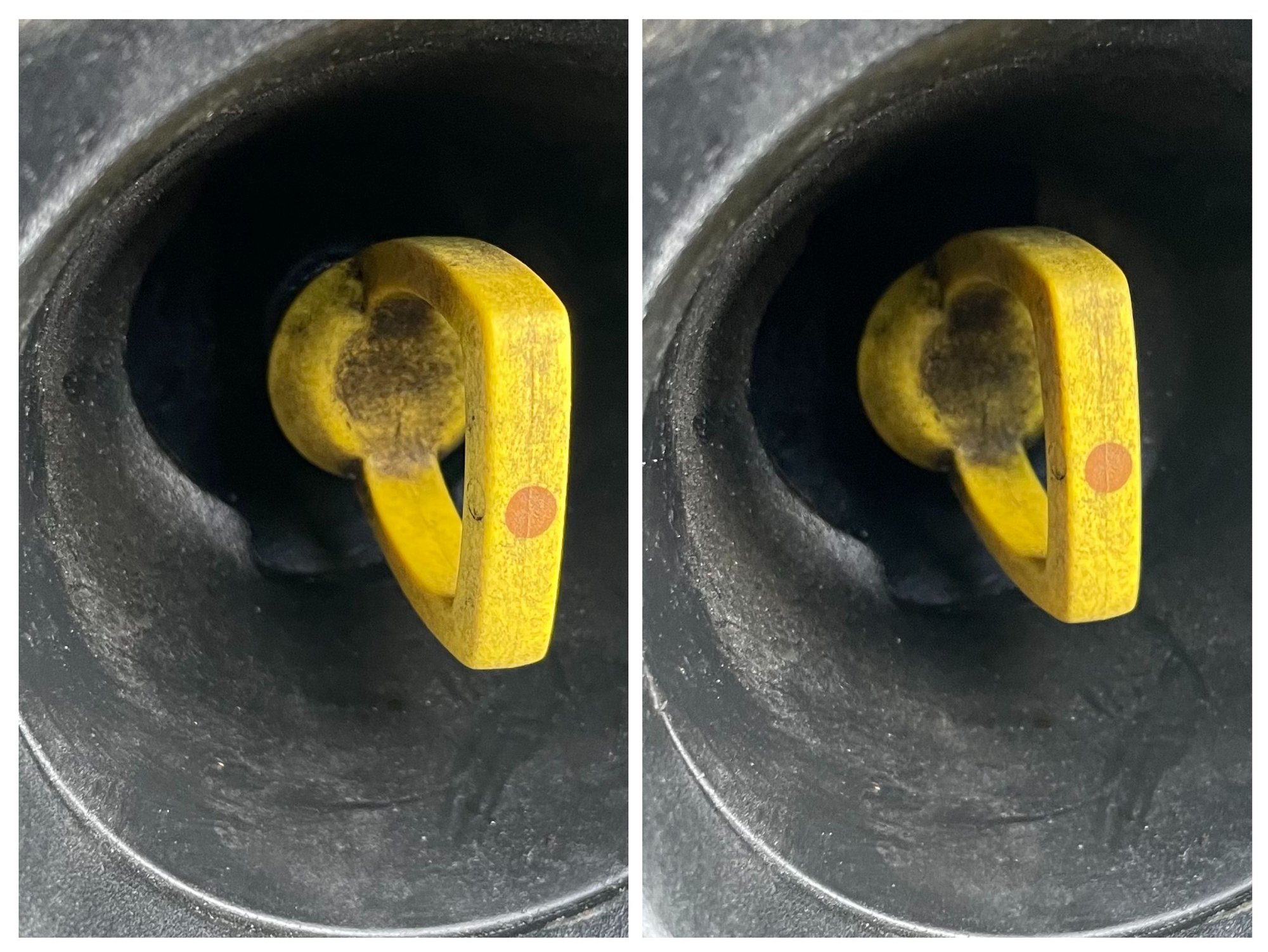

After seeing the comments on dipstick readings I wondered if my 2.0 3 Sport stick length was the same as my 2.5 sky CX-5. Turns out they were different, and here’s a picture. While under the hood I checked the oil in the CX-5. I pushed it down and pulled it out checked the oil it showed ⅓ low between the marks. I thought this was weird since 200 km ago it was full and never used oil and it was an hour after it was shut down.
Again I inserted it until it felt resistance but this time I pushed a little harder and it went past the o-ring to its correct location. This time it was full at the top of the marks. Perhaps it was the cold o-ring and perhaps it was my being cold, -8 degrees C and windy plus can't see it with the cover on but here are a couple comparison pictures. Strange thing is this is the first time I experienced this on either of the cars. Oil is M1 0w20 with Fram Synthetic 6607 currently with 2500 km on it with 122,000 km on the engine and the 4.73 L Jug put it to the top mark back in Oct when it was changed with 0 oil consumption to date. Knock on Wood!!!!!! Moral of the story before questioning your Mazda 2.5 be sure you have done your homework.

While the dipsticks are different you did bring a good point about how DIY check their oil and yes you must push it all the way back into the valve cover completely.
The hard to remove is actually a good sign of the o-ring doing its job. Without that seal you would get blow by that eventually would have vaporized oil scumbling up your engine! Not to mention other related PCV system issues.

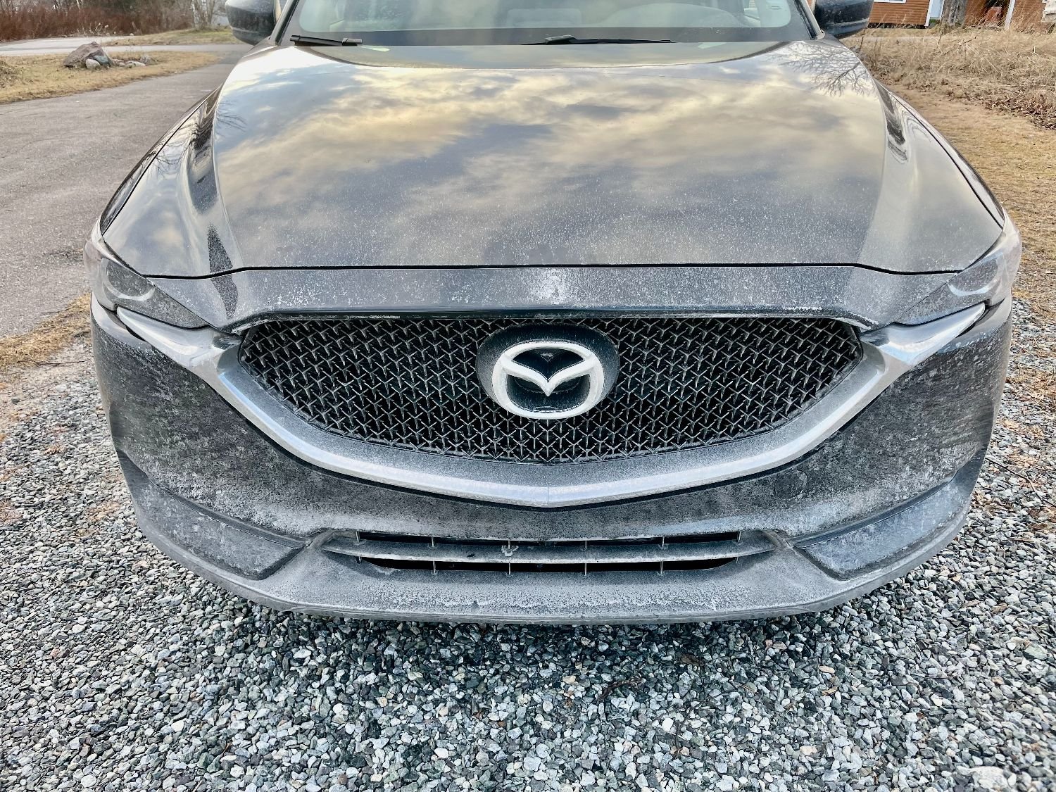

Spring cleaning and bath in April, had it in for corrosion free treatment in October and they drowned it with the following week a dirt road trip. It wasn't rustproofing it was dust proofing. Ultimate pain was yesterday did a RainX complete at the Brushless Car Wash $ 16 CDN it snowed then had to drive 45 min after the Salt Trucks did the highway now too bloody cold to wash it. it was black.

I think you deserve a pass! Kind of hard to keep a car clean in a Canadian winter....

really doesn't look too bad for canada...mine is worse at the moment due to road salt but the white color hides it more than black...i left it out in the rain last weekend and quickly hosed it down to get some of salt off but it snowed this week so it's now worse than it was last weekend
