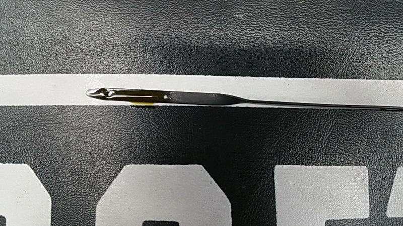

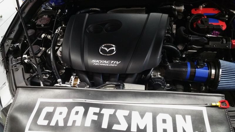

I just changed my oil and filter about a week or so ago... 2018 Mazda 3 with 2.5 , this is 5 quarts @ 130F measured oil temperature, ambient 86F both measured with a Raytek MiniTemp , oh one more thing,0 (ZERO) floor deviation. In other words level ground surface.
In the pictures please lets not talk about *surface tension of fluids? LOL

Your oil level in the pic is exactly how mine looked when I checked before buying.
I can’t explain why I’m getting a lower reading but I’m in the middle so I’m leaving it there with 5.0 qts.
