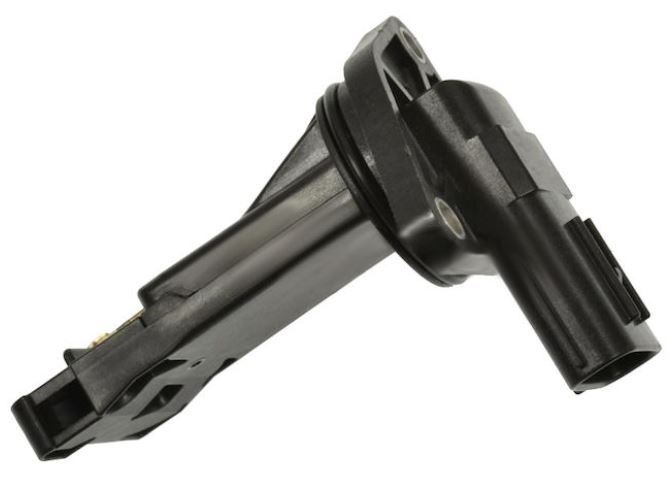

if it is this one then it is not close and easily cleaned.

Looking on your profile and finding other threads you started I see you have a 2020 CX5 .
See many parts for your Mazda :
2020 MAZDA CX-5 2.5L L4 Mass Air Flow (MAF) Sensor | RockAuto
Cleaning sensors
Mazda3 Things I like to do - Page 38 - Mazda Forum - Mazda Enthusiast Forums
There are other on that thread as well
post #377
At the lower plastic housing it is open and with a flashlight you can see up into the MAS. You spray ONLY MAS/MAP sensor cleaner up into that area. Let it completely air dry. DO NOT use air pressure to dry it or you can damage the sensor.

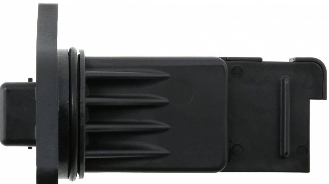

my does not have exposed electric element and it looks like this:
(many videos on YT with one with exposed elements but non like this,... shoud I pry open ...?)

I'm sure you will find openings on the other side. Never seen a MAF that don't expose the element to the intake air.
Looks like this one on Ebay.
https://www.ebay.com.au/itm/225110668886
I see some open holes in the plastic.
Do not pry or use any tool on this part. Just get the proper cleaner spray it and let it naturally air dry only. Do not wipe even with a rag.
