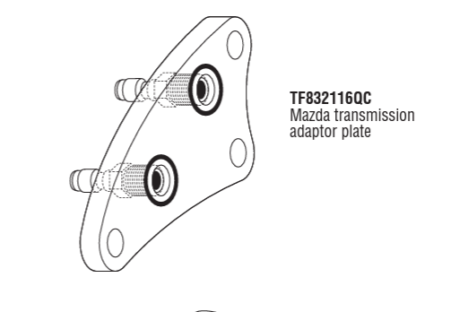

OK. I am slow but catching up. Here is the aftermarket adaptor plate for CX-5 tranny... in place of round cooler.
Yes but to expand a little more it will fit almost all the Skyactiv automatic transmissions.
To confuse some of you all.... I might also add, there is an optional cooler that come with some MAZDA models (I am not sure which) but it has 4 hose fitting 2 for coolant and 2 for ATF. But the adapter you pictured is still the same even for that setup.

Here is another question from a slow learner: Let's say you replace the stock round cooler with this plate and run it to an aftermarket cooler with electric fan, spin filter as part of the hookup, etc.
Now you go back and retire the stock cooler, no longer relevant. You disconnect the two coolant lines from the stock cooler, and... join them together with a Union of some kind? Or go back and disconnect them where they come out of the radiator (or wherever) and seal/plug those openings?
You would first need to machine up an adapter that has larger fitting. The flow rate of that adapter cannot serve the addition of a cooler with added lines. That is why I made my own adapter that has AN fitting that will flow much great fluid rates. If you use flow rate tables for computations you can see why, while it is a good thought in theory to use the adapter as it is it could and likely would have some bad side effects and may not be as successful as that theory in the end use. Now it may be possible if you have a drill press and a good quality TAP and Die set to drill for larger fitting. But the adapter I got was not the best quality material, so this is also why I CNC up my own adapter. That adapter in your picture was specifically designed to work with and really only for Transmission service fluid replacement equipment.

OK. Thank you and Gotcha. Then the cooler comes off, temporarily. The adaptor goes, temporarily, and the PROFESSIONAL FLUSH is done. Then the adaptor goes back in the draw and the stock cooler goes back on. That is, if you are using it for a PROFESSIONAL FLUSH and nothing else. Thanks!
