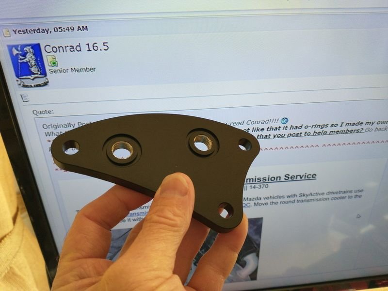

Sorry I don't remember which thread it was on but here are some of the pictures I posted. The "BLACK" adapter is one I made, and the other pictures are the adapter to perform a Professional Fluid Service on a Mazda Skyactiv Transmision.

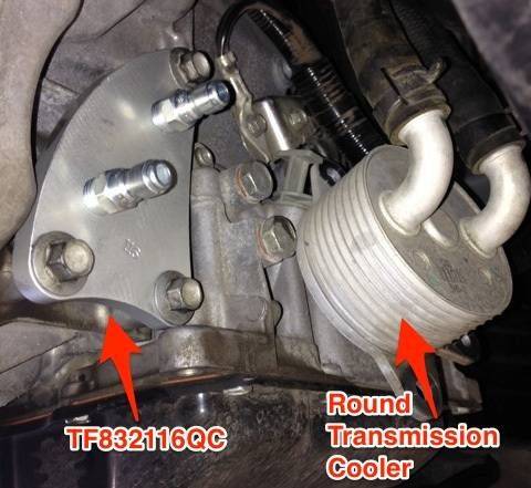

Thank you. Correct me if I am wrong: the stock trans cooler (which has coolant circulating through it) stays in place, the adaptor plate is next to the round trans cooler (as in your picture) and can be used to a trans flush, and also lead to a second external trans cooler where the trans fluid itself circulates through (and also can have a spin on filter attached).
Is that correct? Or are you actually moving the round trans cooler to a different location?
Thank you.

Here is the cropped version of explanation in the 2nd picture

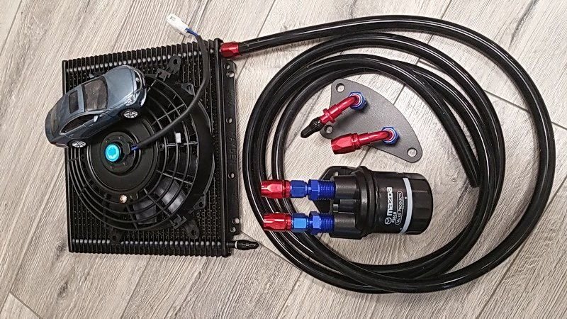

Originally Posted by reubenvabner
trans cooler ....., the adaptor plate ........ external trans cooler ......spin on filter ......
...... trans cooler to a different location?
Thank you.
Post #191 starts the project...I have not yet completed it however.
Mazda3 Things I like to do - Page 20 - Mazda Forum - Mazda Enthusiast Forums
Here are the basic parts I have machined or acquired for the project. I may still make some more changes as I get closer to the actual installation. I have not yet finalized exactly how I will be controlling the fan yet either nor have I started the relay and switch harness for it. I did swap out the original intended cooler for this one in the picture. The Transmission inline filter adapter can be used with many brands and type of spin on filters.
All parts are only lightly placed for the pictures. There respective type and location may change during the installation. The hose in the picture is not high Pressure hose and will be
changed out for High Pressure hose for the installation
