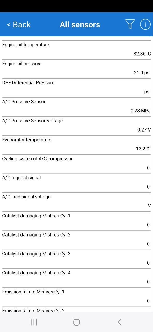

i purchased my iCar OBD2 scanner and i can see that my Commanded valve purge in idle is 27-30% and if i lightly press on accseleration up to 900 rpm its decreasing to 5-7%
as well as my catalyst Evaporative system and Oxygen sensor can't pass emission test at Car Scanner program. and sometimes my engine do misfires
today i took out o2 sensor it's perfectly clean i instaled it with 24 ft-pound as it was already installed my car had a huge power loss , i de-install it and installed it with 32 it's became better but still bad, i took it out and installed with 30 gave it 3 minutes and installed with 37 ft-pd
now it's almost fine but after i drove 30 km still error in emission catalyst and o2 sensor and commanded purge valve still 27% in idle.
