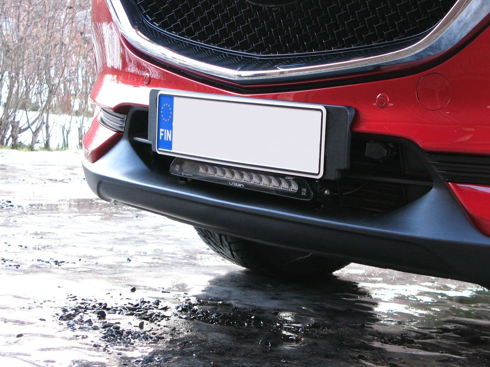

This type fits under licenseplate in the gab. https://www.lumendaylight.dk/lumen-h...SABEgKI2_D_BwE
Its a stolen picture

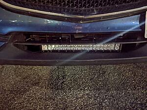

Here's my solution. I made an aluminum plate inside the plastic bumber, see the red drawings. Light bar is Lazer Linear 12 Elite and despite its small size, it has a very good light output and pattern!
