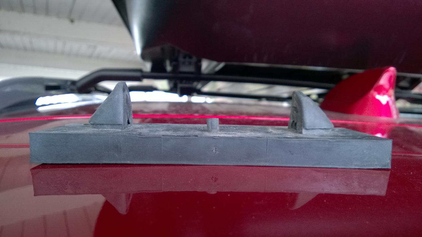

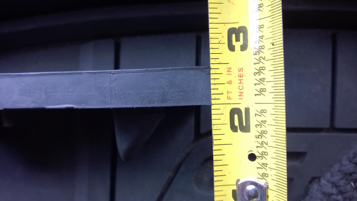

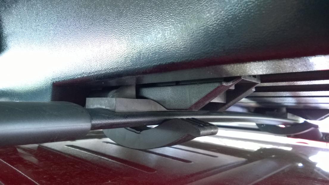

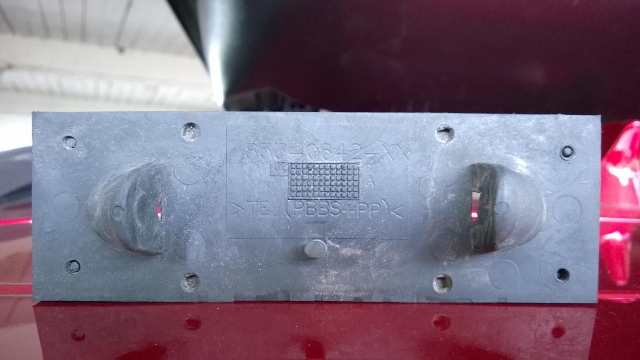

The Yakima does touch the rear antenna fin and push it down a bit, looking into getting some 1/4" or 1/2" spacers to raise the rear of the Cargo Box off of it.

Where did you take it to that they took your old box as a trade in? Also, what kind of spacers are made to raise the rear of the box? Or are you just going to come up with a homemade fix? I'm going to need to do this myself before long.

There is a place in Portland, OR called ReRack. They specialize in used racks, hitches, and hitch attachments. They carry new stuff as well.
I went back there after the purchase and asked if they had any spacers, they told me they did not carry and spacers specifically but they would give me some hefty pieces of rubber that "might help".
I am not sure if he was messing with me or not but what he gave me seemed to fit like it was made for it! Result, I now have plenty of room between the box and the fin antenna, even when loaded.
