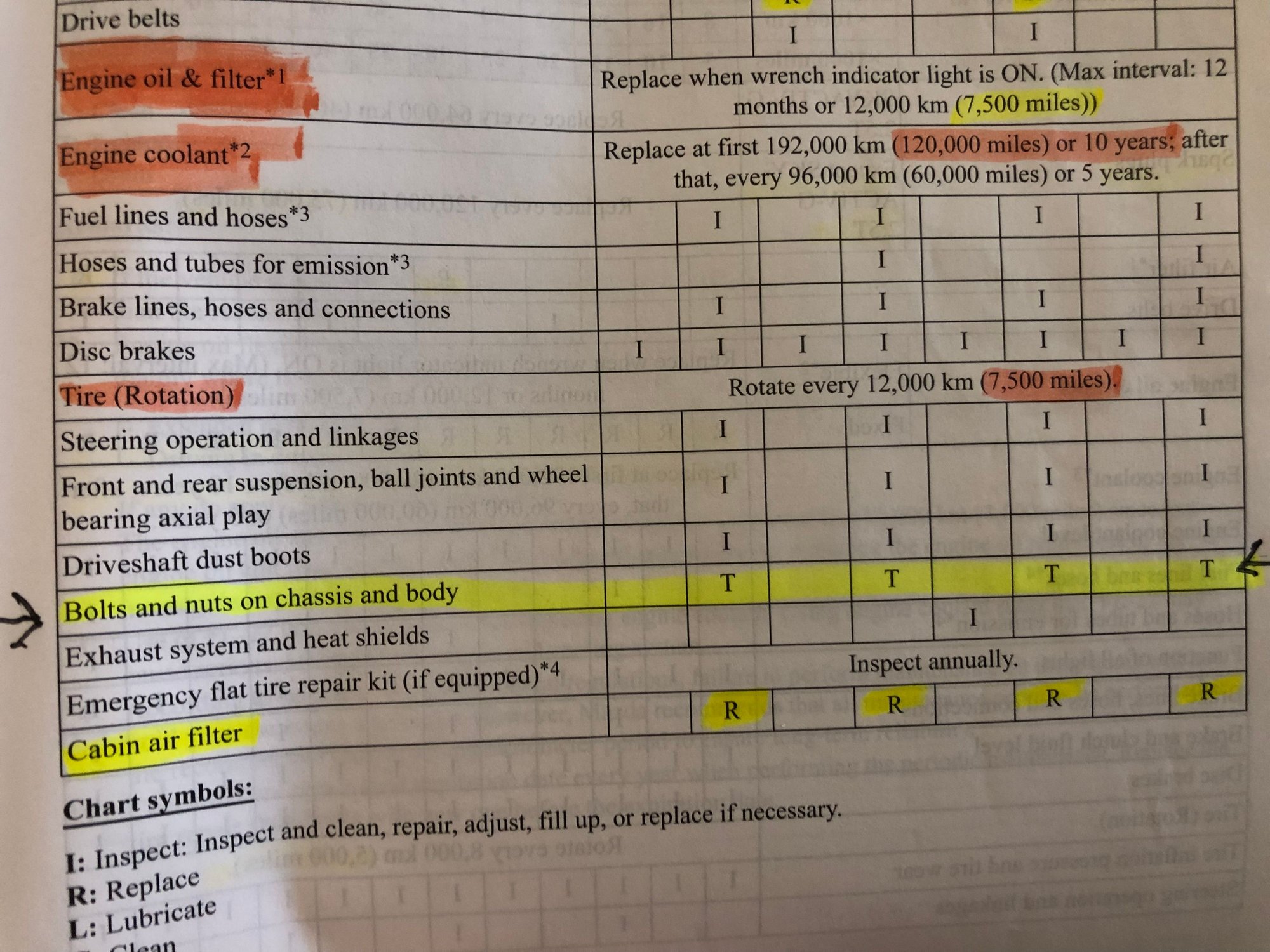

Thanks Calisto - I refered to the scheduled maintainence in the owners manual and on both schedule #1 and #2 ( severe conditions ) it reccomends " T " tighten at 15k mile intervals not 7500 - so im not sure i will do it again at 30 or 45. as Im not doing any hard driving on ill maintained third world roads.
but heres the reccomendation right from the owners manual -
Schedule #1
schedule #2

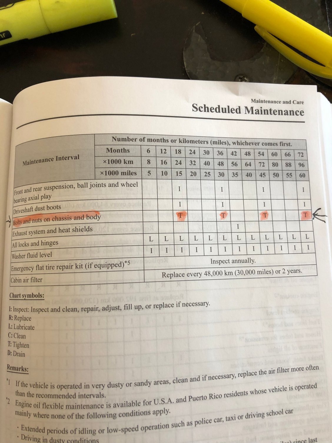

well,well well look what I found in my own file notebook OWNERS schedule guide. I even copied it originally to make notes.
This is for a 2018
No excuses I just not use to seeing this on a service schedule. And maybe that I am under the car so much and hyper sensitive to anything that is not normal in sounds and feeling of the Mazda? IKD. I will say when I read this in my car I looked at sever owners scheduling from other car, i.e. BMW,MINI, Ford, Chrysler and a Toyota and none were like the Mazda? I am sure now seeing this that there are more then what I thought and will add that to my courtesy service for some of our regular customers in the shop
