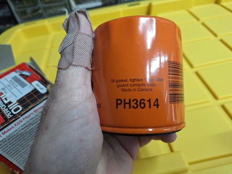

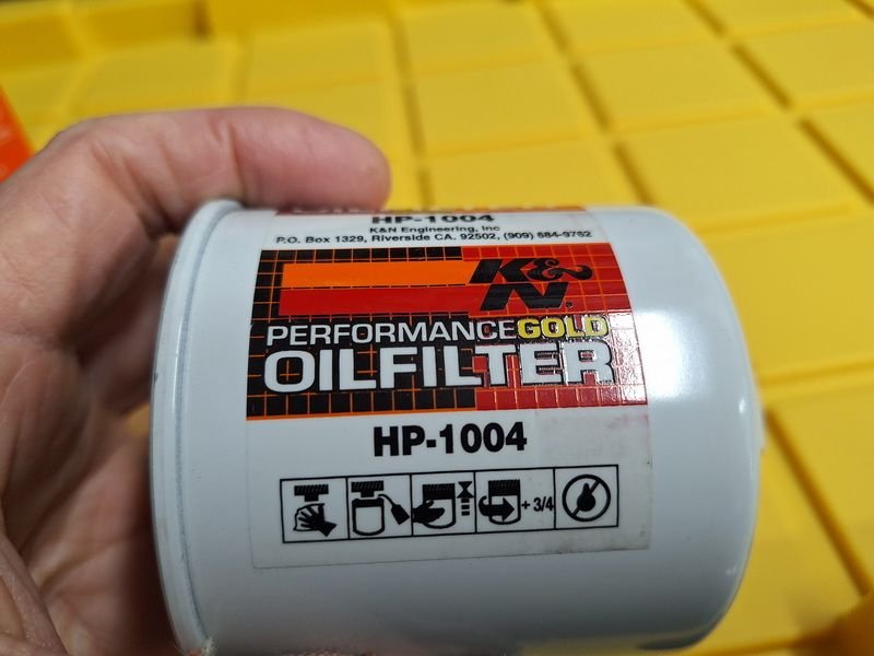

I never use a if filter wrench and always hand tighten. There really is no need for a oil filter wrench if you install an oil filter correctly. Funny I wonder how many have actually read the oil filter manufacture information on how to tighten their oil filters? You theory could be plausible but will never know. The rubber sealing ring when it is even slightly compressed will not allow the oil filter to rotate. I would venture to say that it is more likely oil has been slowly leaking from the oil filter for that period of 6 months. You can semi confirm this by looking at the oil trails splattered in and around the oil filter.
To answer your question, you over tightened the oil filter which is fine. LOL Most spin on oil filters you rotate until the seal just starts to contact the oil filter adapter. then about 1/2 to 3/4 turn? If it is starting to feel like you really need to grip and turn you either need to exercise more or you are really making it tighter than it needs to be.

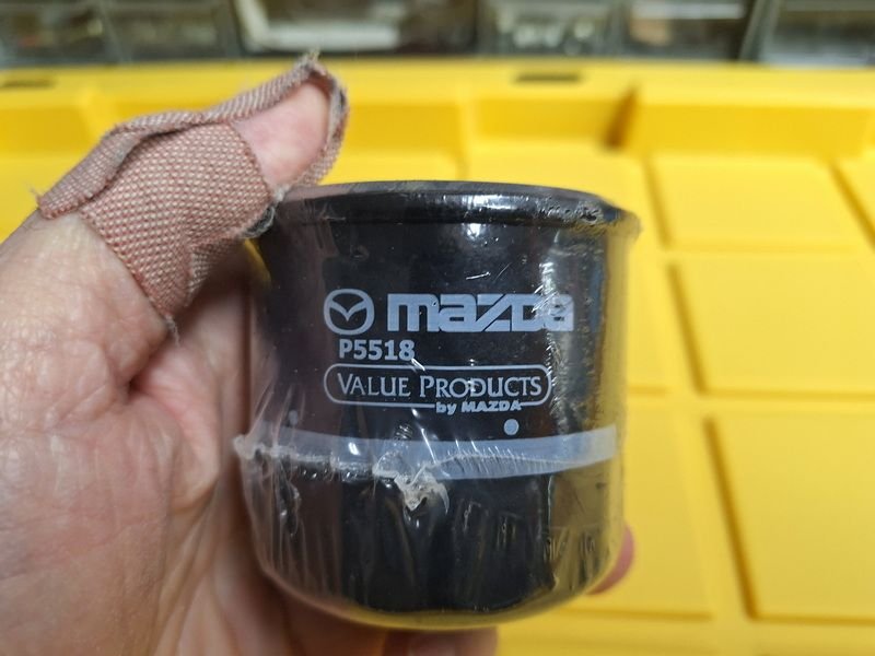

Funny Mazda OEM oil filters have no printed install info like aftermarket oil filters. Why is that , if I answered that to many would take offense as to the historical reason not just Mazda. But if you were a mechanic at the dealership, you could access the oil filter install information in the factory service manual.
