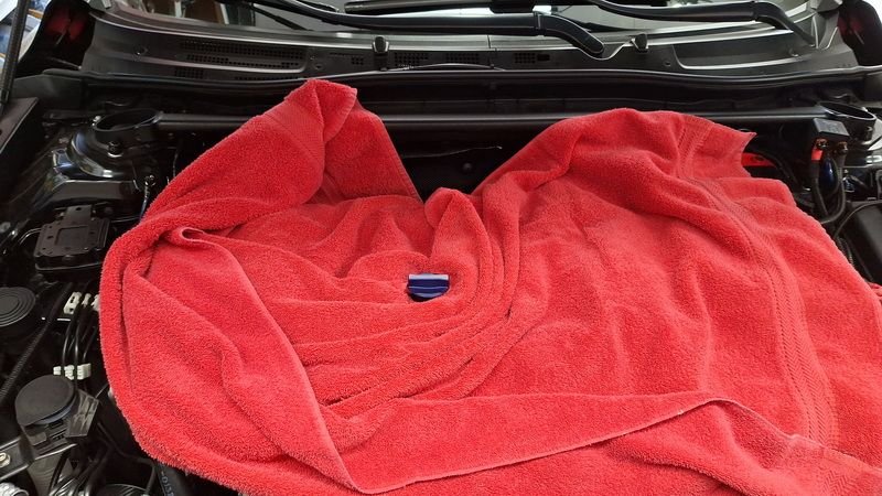

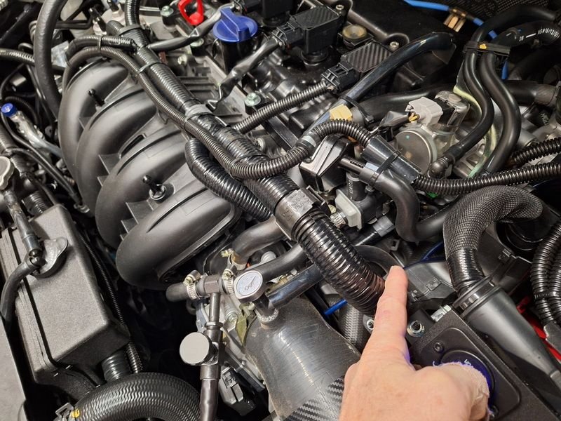

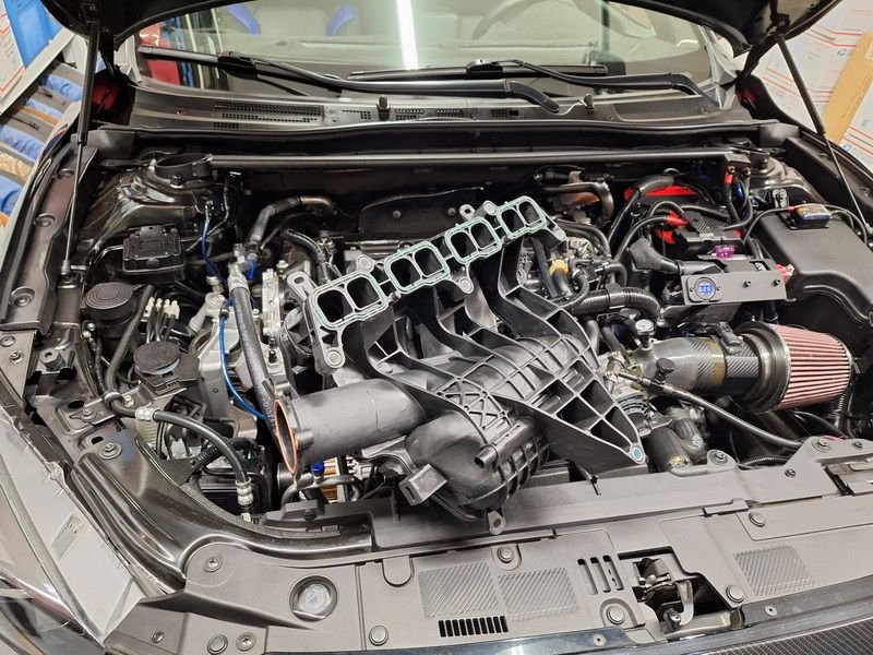

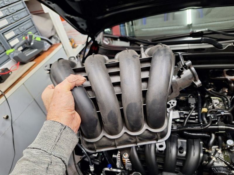

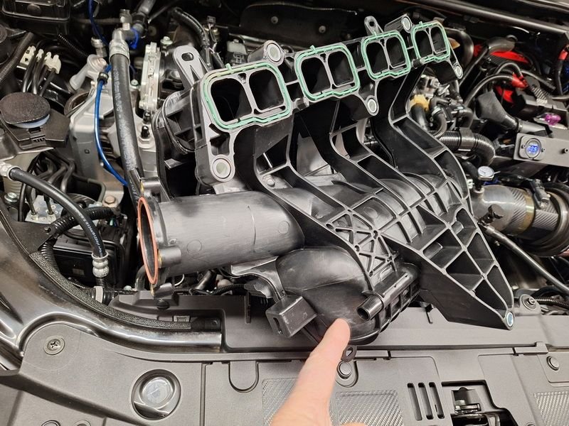

So I just went and took these pictures and even a 16 second video
Old Jan 29, 2025 | 12:19 PM
Posts: 10,616
Likes: 231
NOTE: my engine is completely cold, and this was the first time starting it today. If you look you will see the air pressure and the oil droplets being blown out of the oil cap area.
This is NORAMAL for most all gasoline modern engines from at least 2000 to present.
Some even notice that removing my oil cap may seem harder than most and that is because I not only replace the O-ring on the cap every oil and filter service but use a larger diameter(fatter) O-ring for a firmer fit.
