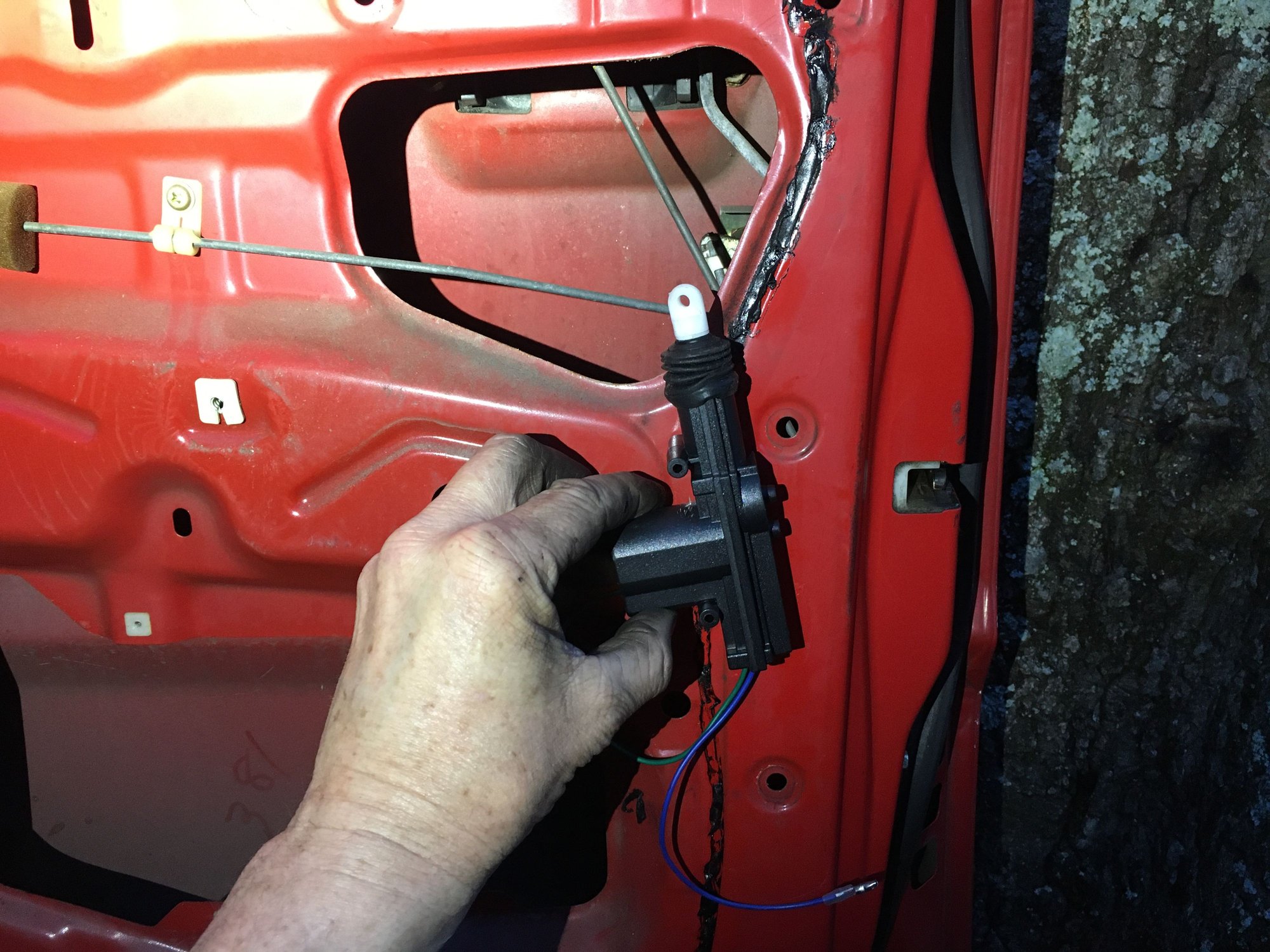

When I get in there to lube the regulators I’m gonna check the door structure and lock mechanism to see if it’s not too difficult to install universal lock actuators. Then install and alarm and keyless entry like this kit perhaps

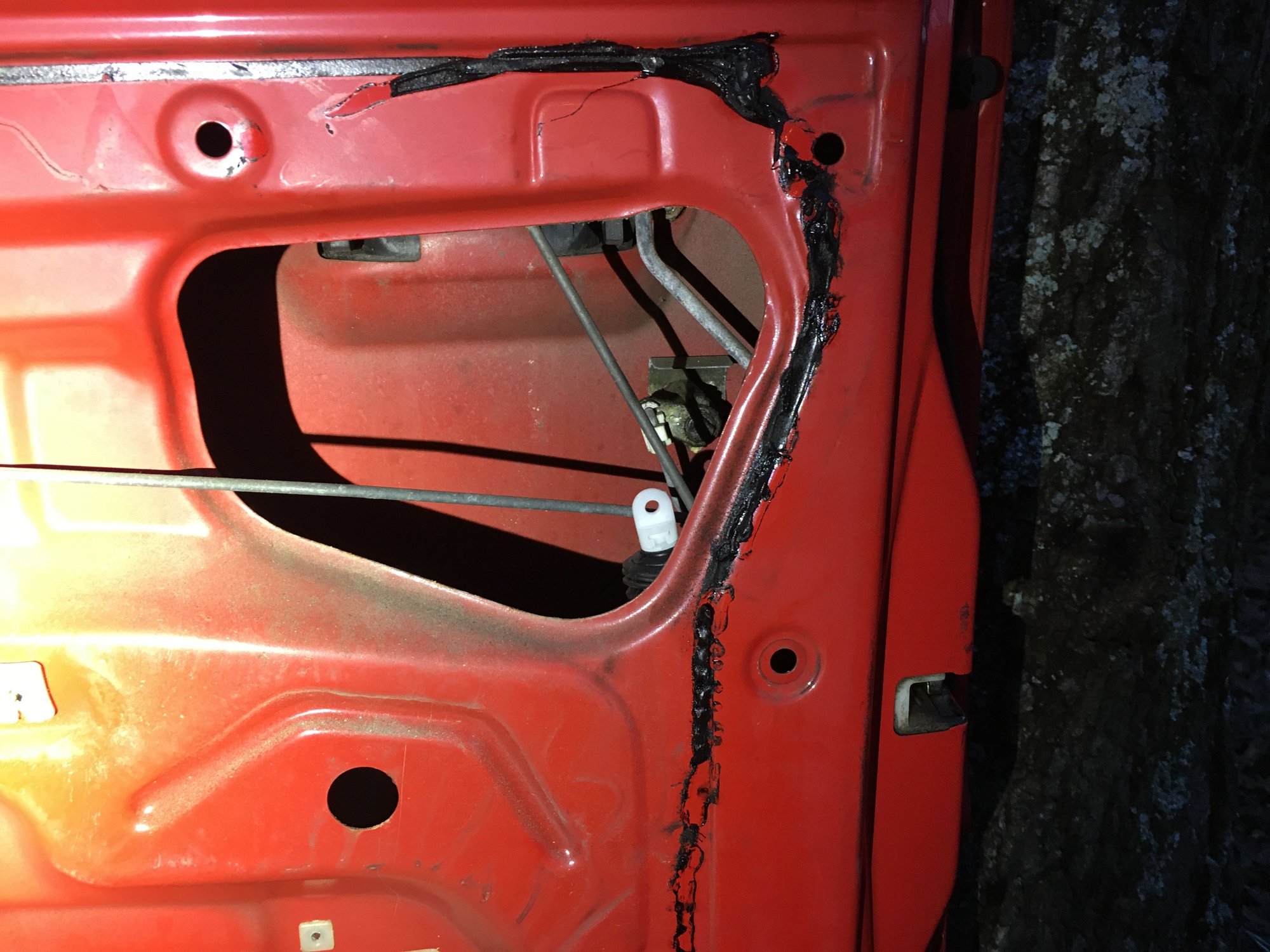

Looks like the universal door lock actuators will not be too difficult to install. There’s a good position with good clearance. The two pictures show the basic position. First picture I’m holding the actuator in the position it will be in inside the door. The second picture I’m holding it inside where the actuator link is visible

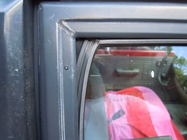

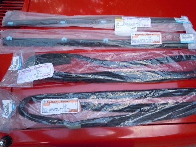

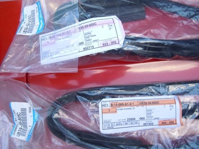

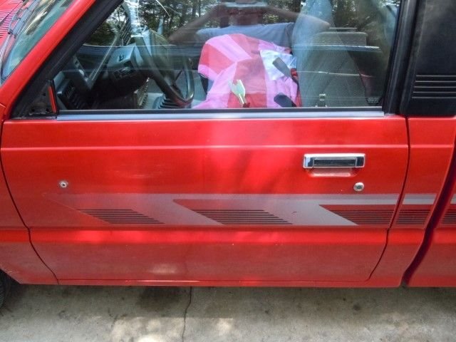

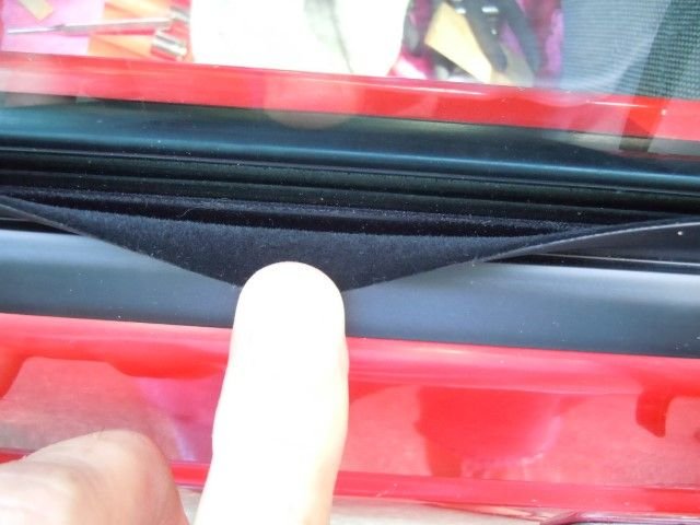

What I have found out with our Mazda trucks and the hard to roll down windows is, that the window run channel is the culprit! Go to your Mazda dealer and get new window run channel and install it......you will thank me! What happens as the rubber ages, is that it shrinks and gets hard and non-pliable......this does 2 things......it grips the glass too much, and the run channel length gets shorter.......and therefore it doesn't fit the door frame (lengthwise) as it should!
I just did this to one of my neighbors/friends truck yesterday......the windows roll up and down like a new truck now! If you have a single cab truck, you can also buy new "Door Belt Weatherstrip" that is on the outside horizontal lip of the door.......your original ones are rock hard and they help scratch your glass every time you roll the window up or down!
Here are the pics of one of my trucks that I changed a while back......
Both of the window run channels, & the door belt weatherstrips.
If your window run channel is doing this in the rear upper corners......they are not letting your glass roll up and down as it should!
New door belt weatherstrips......
Bet you can't do this with an original door belt weatherstrip!!
