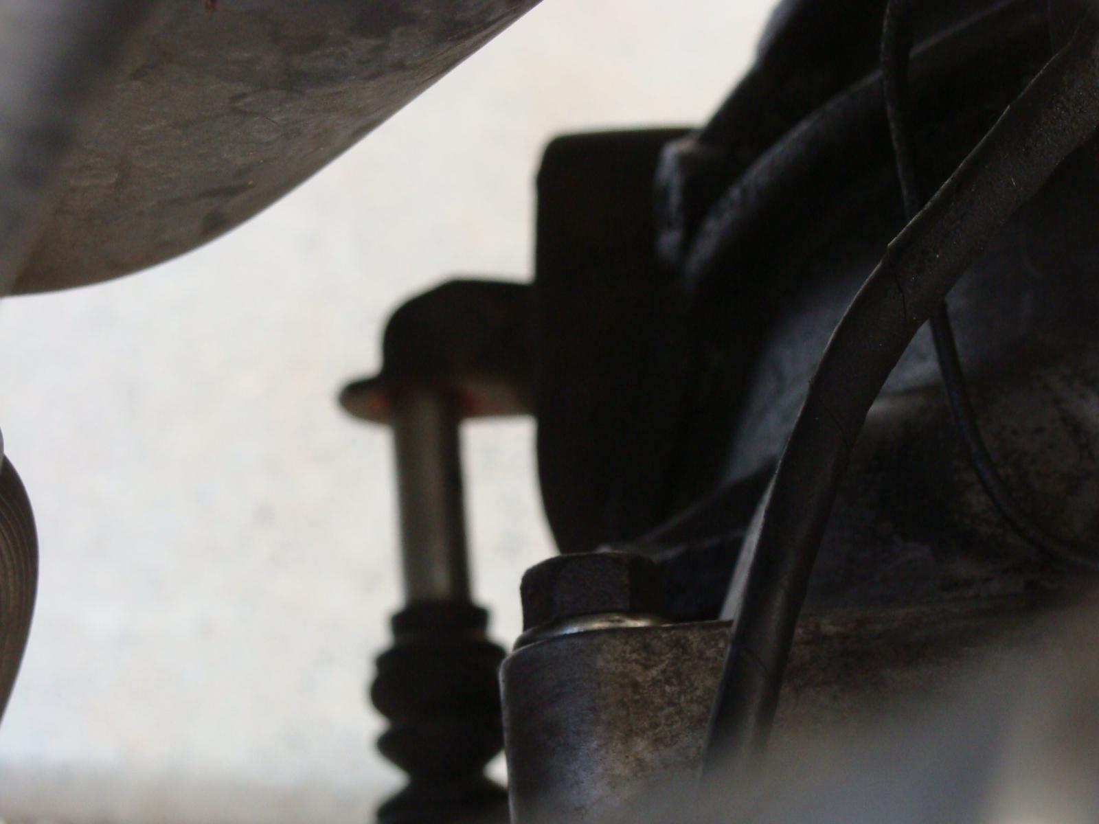

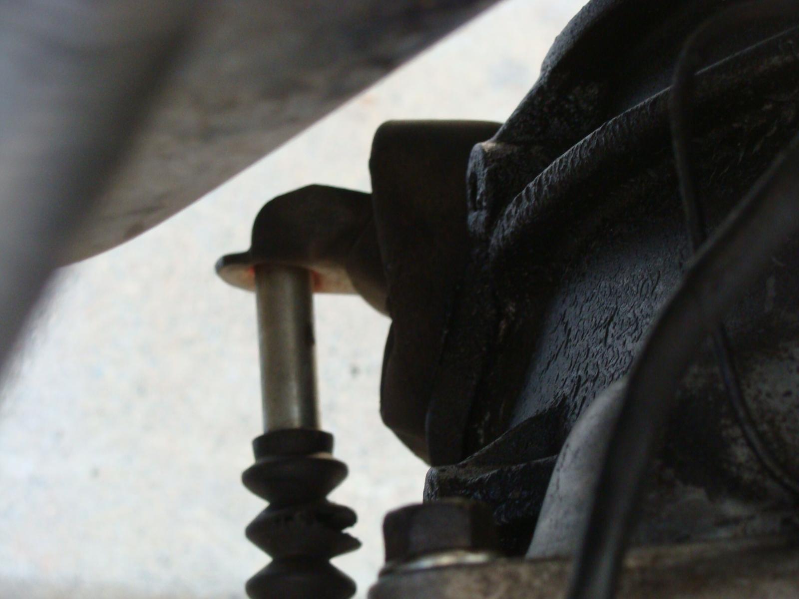

Here is what my slave cylinder/clutch fork looked like in 2013
