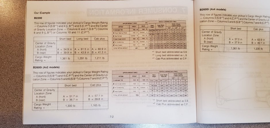

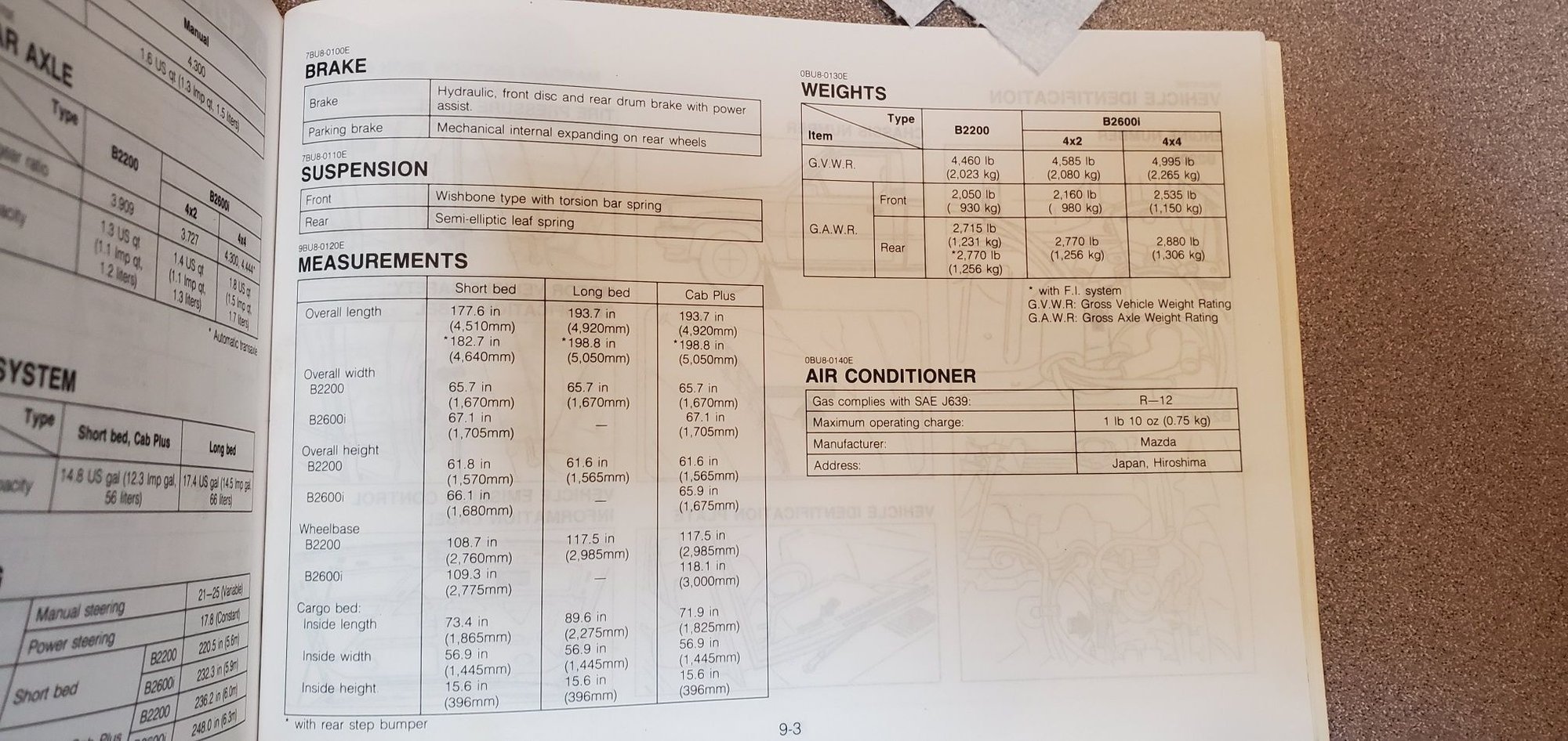

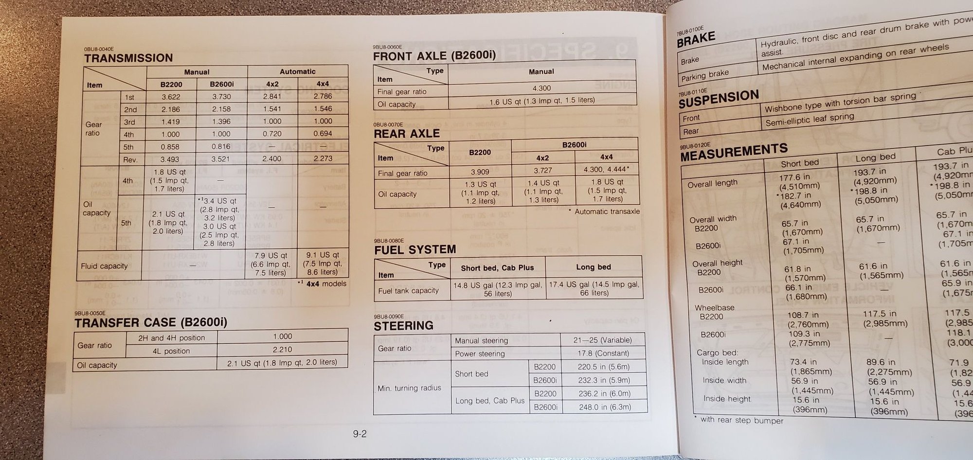

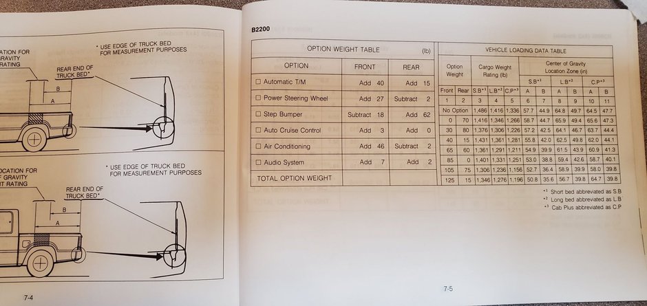

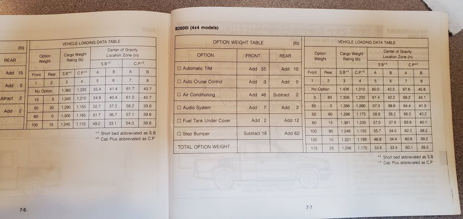

Yes, to a degree. I am downloading some pics from the 1991 Mazda Owner's Manual right now and I will post them here for you to save and read through.

Hello, these are very helpful, could anyone help me decipher if the truck (4x4 b2600i) can hold a slide in and what weight? it seems like they are rated for 1/2 ton and 1 ton trucks but I don't know how to tell what this truck is. I'm trying to buy a slide in and just not sure what to look for, thanks for any help!
