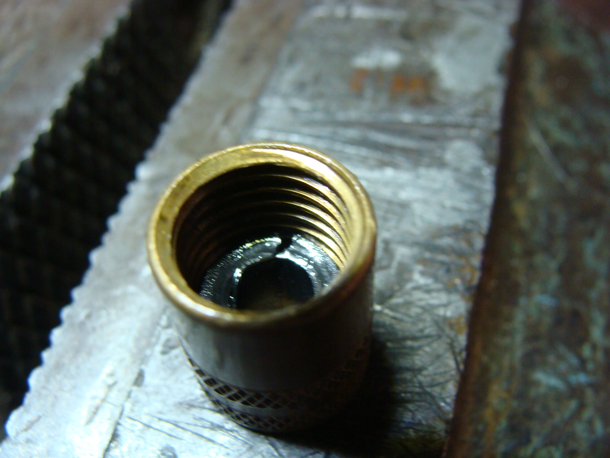

My own 1988 Mazda B2200 leaked out most of its R-12 in the last 6 months, I'm currently leak checking this. My own cause could be related to a bad rubber seal in the AC service valve cap, see photo.
