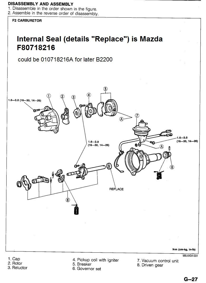

I think it might be time for a new distributor, that play up/down seems like a lot, plus the vacuum advance. You can test to see if your carburetor is actually pulling vacuum, and also test that when a vacuum source is put on the vacuum advance that it holds vacuum and also causes rotational movement in the distributor.
I've only partially taken apart a B2200 distributor, and I've attached what I did.

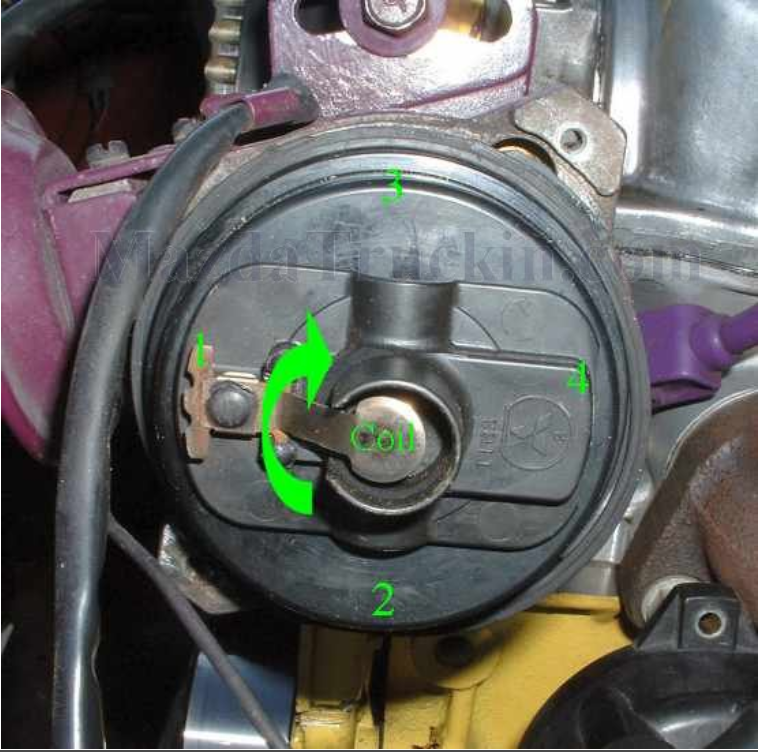

Was the distributor "stabbed" on gear tooth off?
As per the timing light: does it not flash at all when connected to the battery terminals and the #1 spark wire? If so, did you try a different spark lug wire just to see if it flashes?
Show us a picture of distributor with cap off while at TDC #1 so we can also see where the mounting bolt is in the "arc".
Also see B22TimeCheck.html

So I am at work. However when I did stab the distributor in. It was at the same point in the picture you referenced. I assumed it was a gear off too. However the top cam gear pin was at 12 o clock. So it seems it wasn't a gear off.
