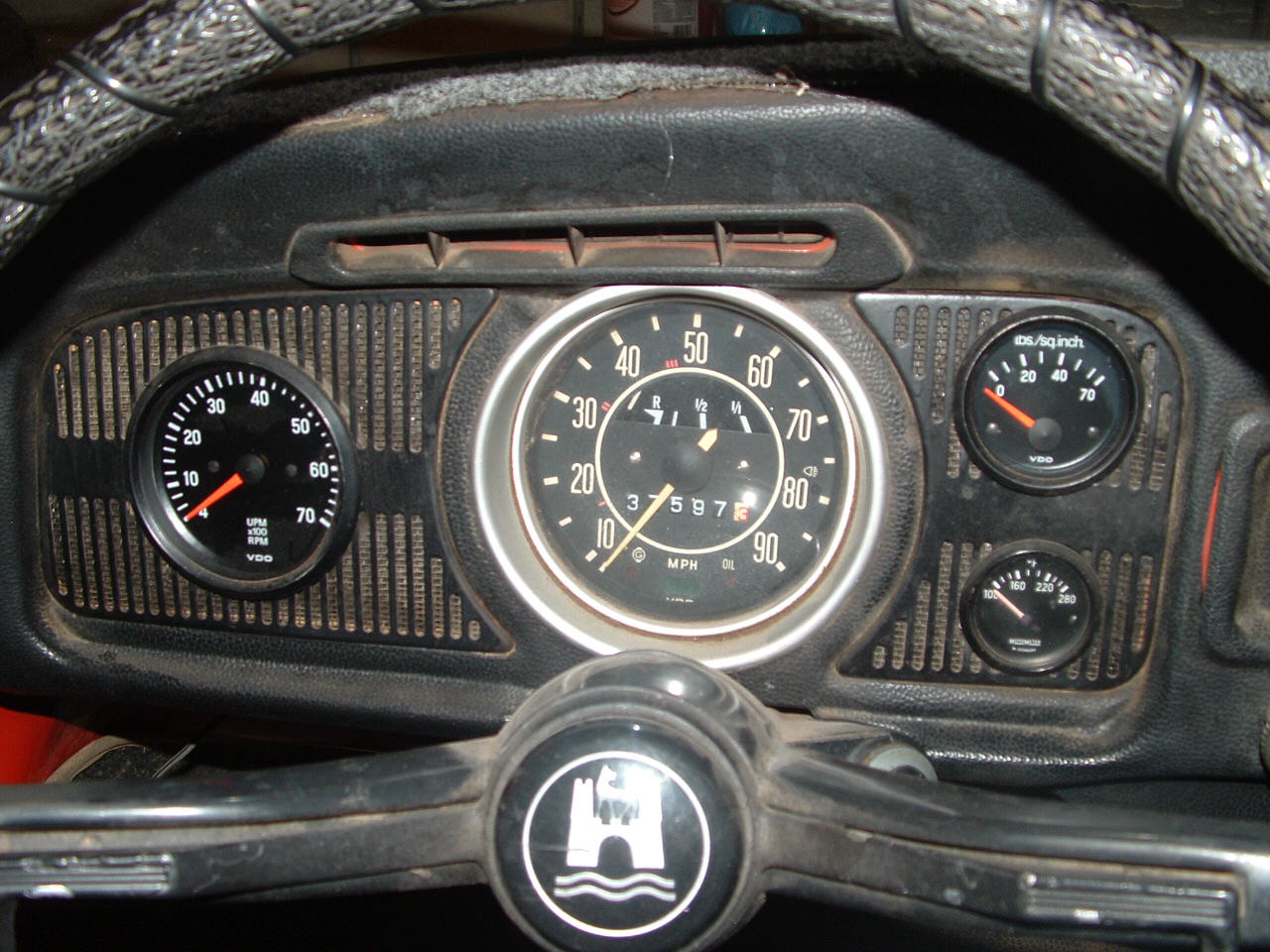

I've had a VDO analog electrical oil pressure sender and gauge on my 1835cc VW engine since 1977.
