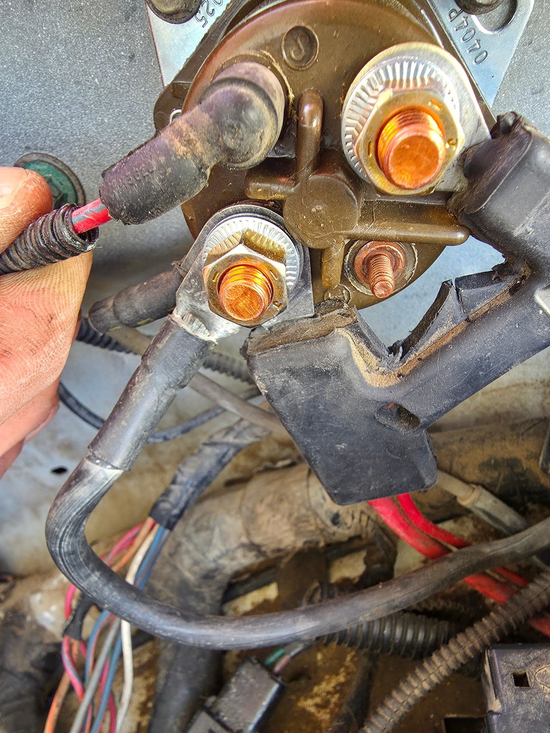

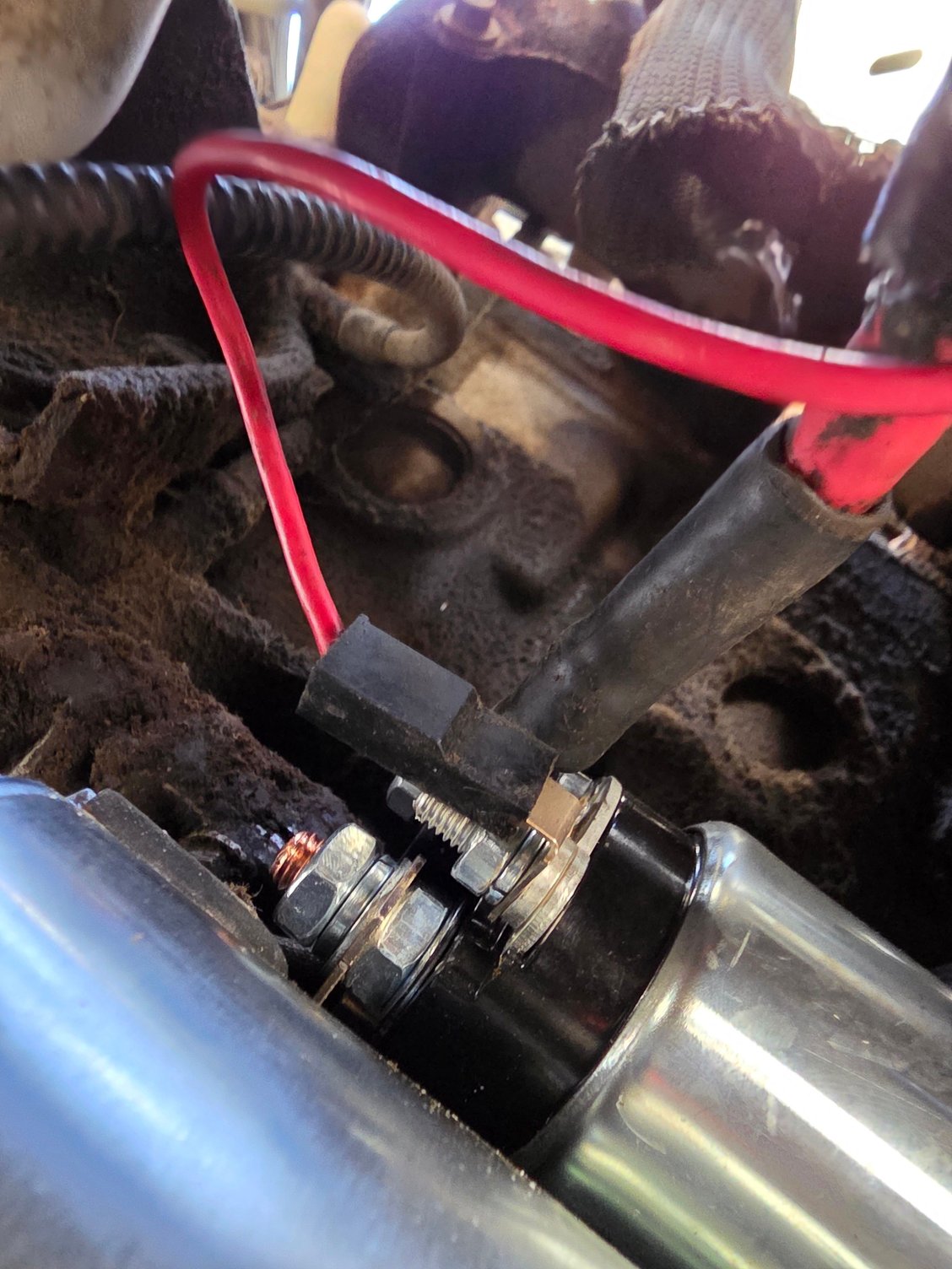

Follow the large grounding wire from the negative battery post to the? Does the wire connect to the truck FRAME anywhere? Does the wire go directly to the starter bolt? Does the wire go to the truck frame and then the starter bolt? Does the ground wire split off and connect a smaller wire to the inner front fender of the truck?
If you could post some photos of your truck's engine compartment, particularly of the positive and negative battery wiring......that may help us see what you are dealing with.
Old Jan 31, 2026 | 01:12 PM
Yotadrvr's Avatar
Joined: Jan 2026
Posts: 10
Engine ground.  Removed and cleaned at both ends.
New relay.
New relay.
Start ground. Cleaned
Constant and ignition. Cleaned, both have 12v or higher.
