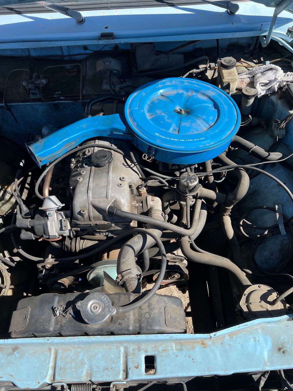

New member here. I picked up a 79 Ford Courier that has the Mazda MA 2.0l 8V engine. Bought it with a known blown head gasket, and tore into the engine recently.

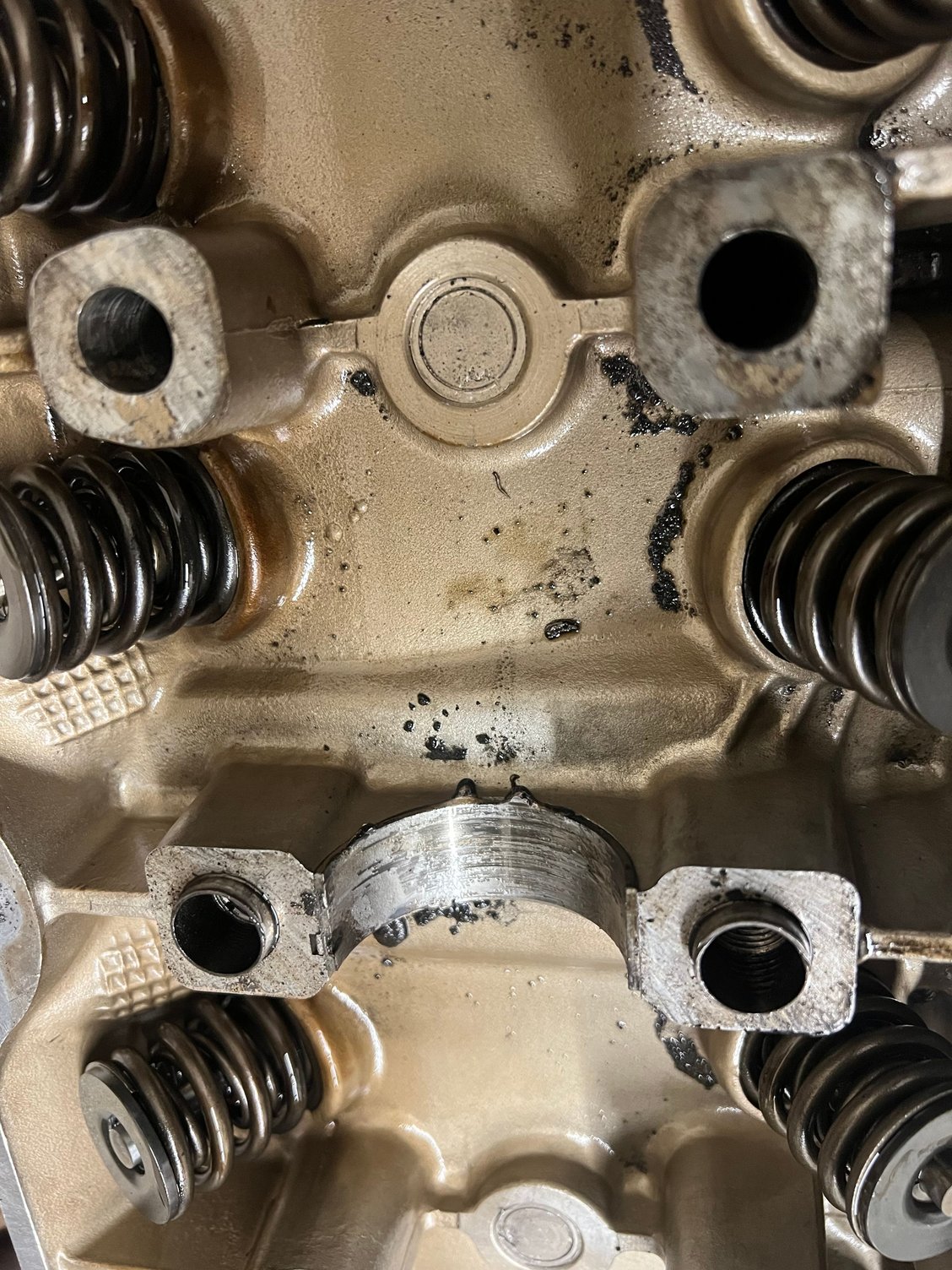

Camshaft bearings. When I pulled the cam, the cam bearings had literally looked like the babbit material melted on them. Like the cam journal pushed molten metal to the sides of the bearings where it turned into slag. Looks almost as if someone who couldn’t weld was going at them. Never seen this damage before in an engine.
New bearings are almost nonexistent but I know I’ll figure something out. The closest I’ve come is King bearings has a set CS330BB. On some sites it’s listed as a replacement for a 79 2.0l engine. Kings website has it listed only for the 1.8l engine for a 72-79. Normally I’d take this at face value, but on a few sites like rockauto, I’m seeing the cam bearings part numbers are the same for the 1.8 and 2.0l engine for a 79. I’m tempted to buy a set from Kings and see if they fit because it’s the only option I’ve found so far. Does anyone know if there’s any difference between the two engines cam bearings?

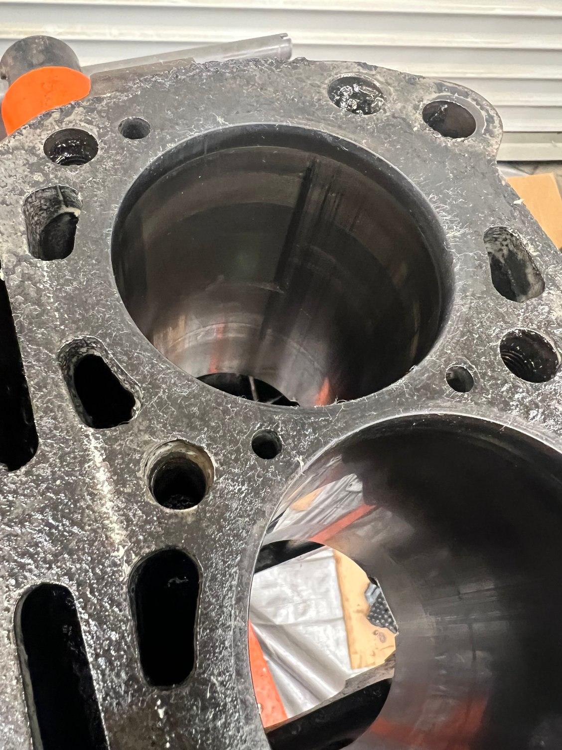

Bought .030 pistons and rings. Plan to overbore. Can feel the area where the rings sat with water in the cylinder.

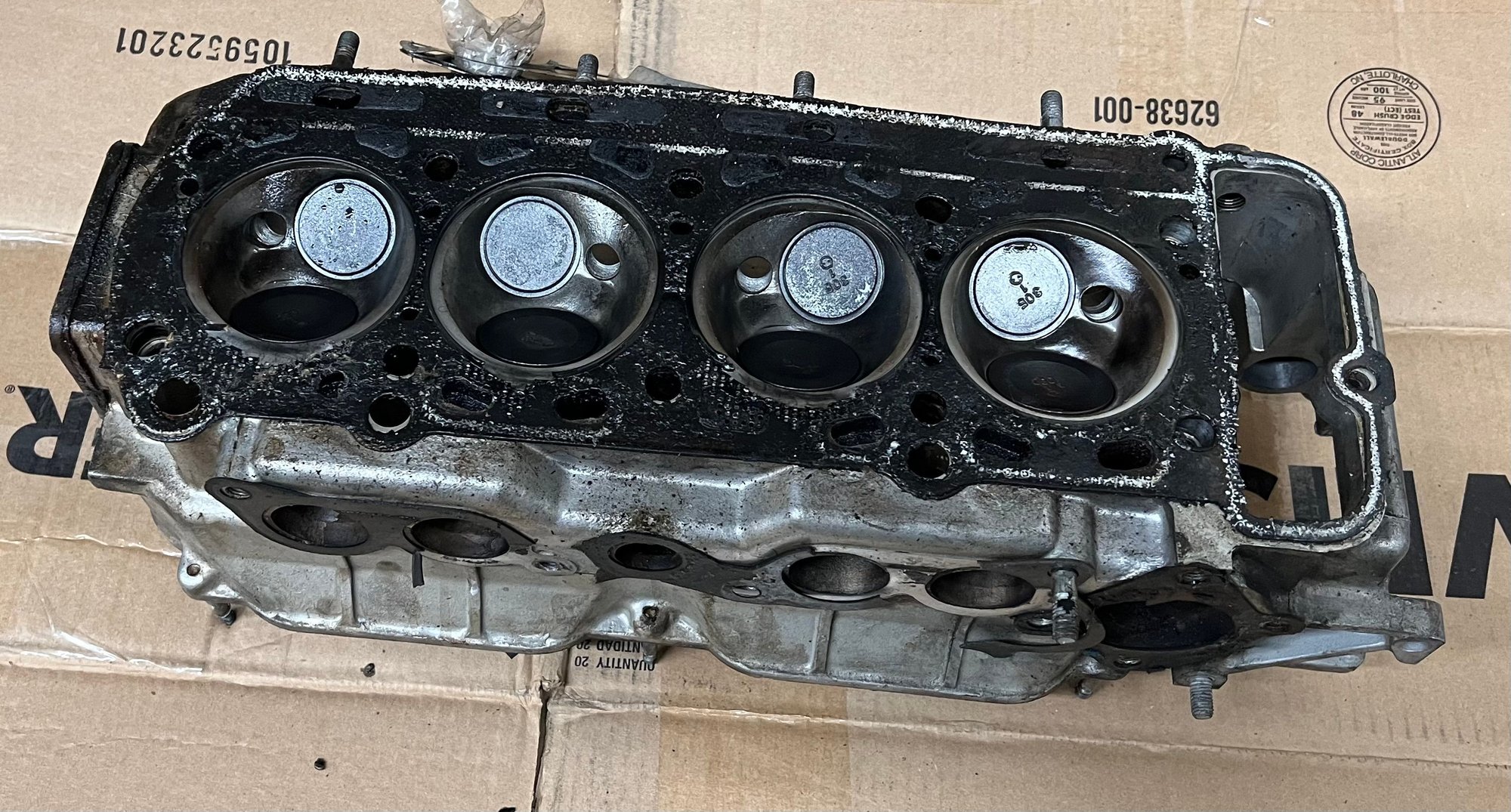

https://cimg4.ibsrv.net/gimg/www.maz...cec464718.jpeg
Before old head gasket removed and cleaned.
https://cimg0.ibsrv.net/gimg/www.maz...3b6d9fc01.jpeg
After cleaning.

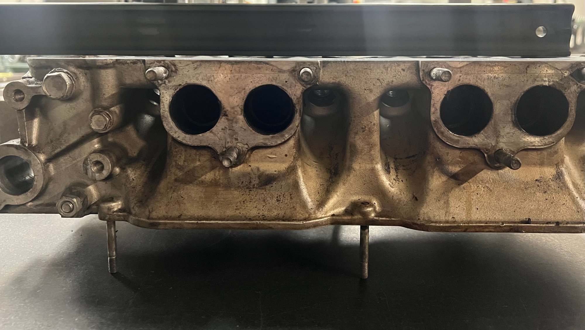

https://cimg4.ibsrv.net/gimg/www.maz...e598a3c26.jpeg

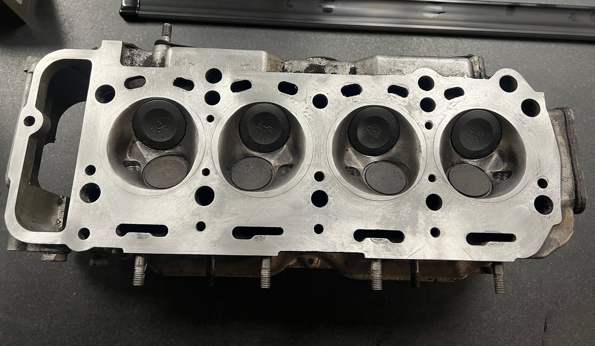

Head warped like a banana 0.018” in the middle. Gonna have to try to straighten this before even thinking about shaving the head because the cam towers are gonna be warped as well. (I suspect partly the cause of why the cam bearings were toast)

Close up of a runny cam bearing

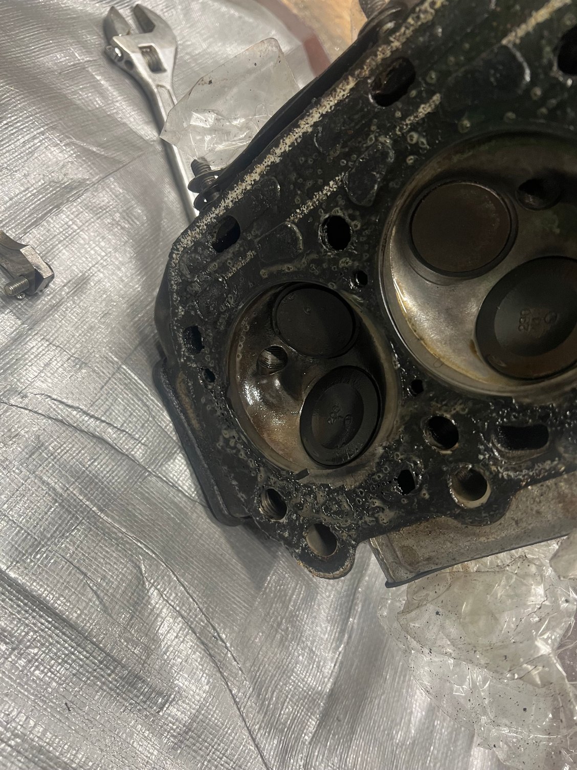

https://cimg3.ibsrv.net/gimg/www.maz...ee9fc99c8.jpeg

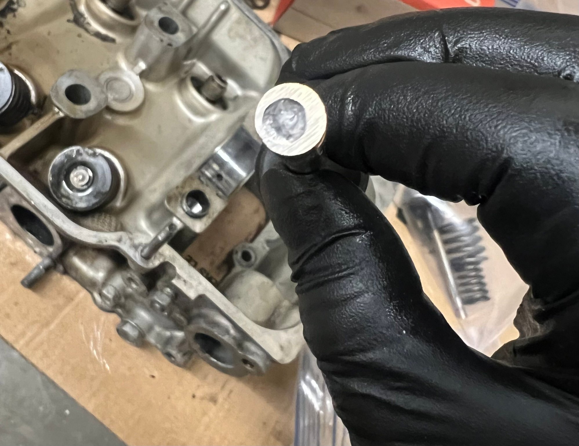

Interesting valve stem tip wear. The picture makes it look worse than it is, but I’m replacing all with NOS Manley and TRW valves found on eBay either way.
https://cimg4.ibsrv.net/gimg/www.maz...dc28938be.jpeg
Hand ground valve stem tip?? I don’t even know what was going on here but it’s crooked and can be seen by the naked eye. It also did not want to pass through the guide.

I ended up sourcing a good used engine for the rebuild. I got the original head straightened to under 0.010” with an acetylene torch but I got to thinking. I’m almost positive that head was off the car before, and I know it had work done to it. That I’m guessing includes resurfacing the head. The service limit is 0.010” removed total. I bet it would still be ok if you went a bit past that, but I’m not interested in gambling.

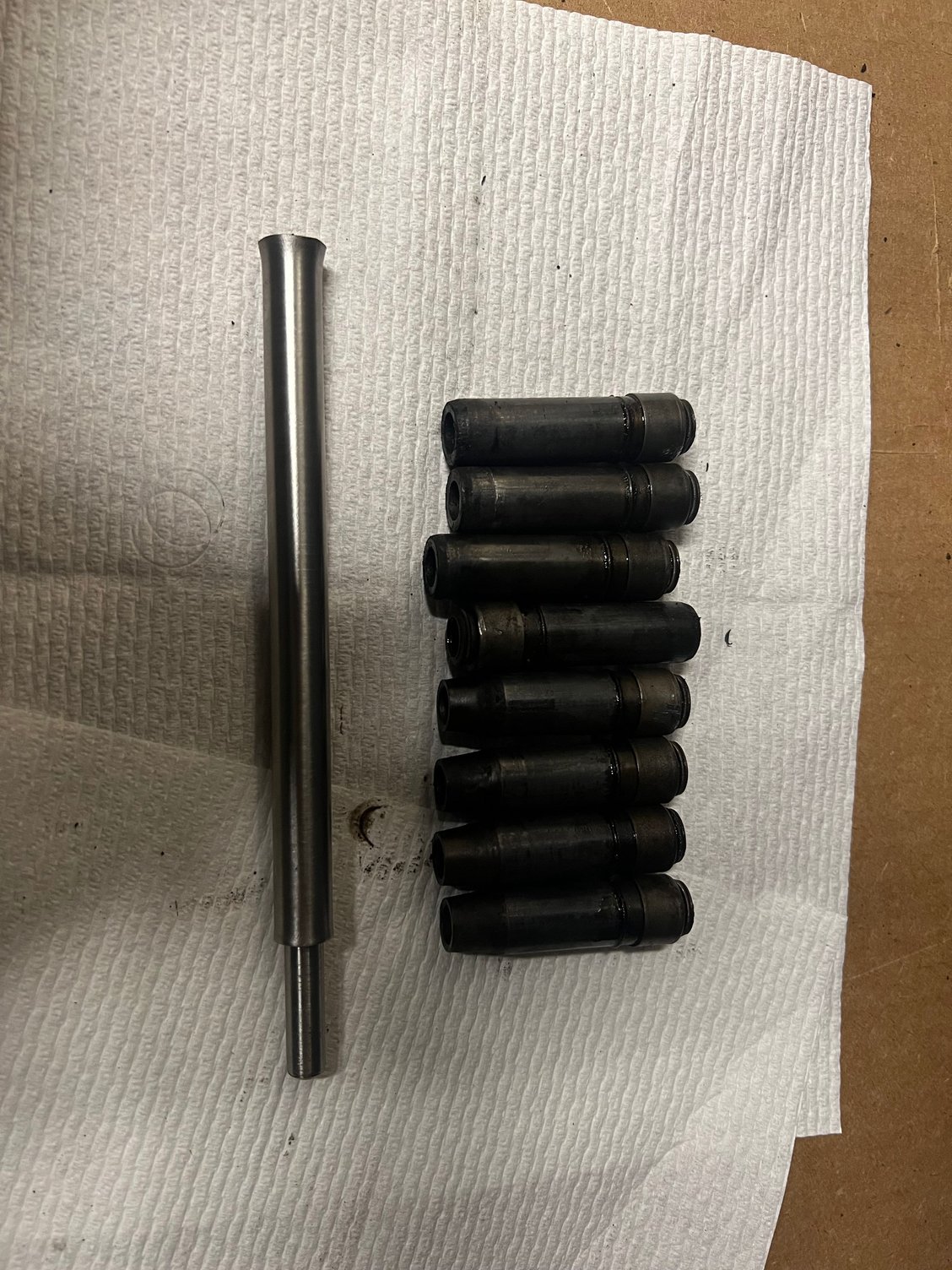

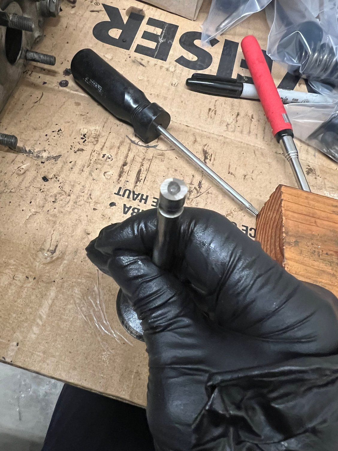

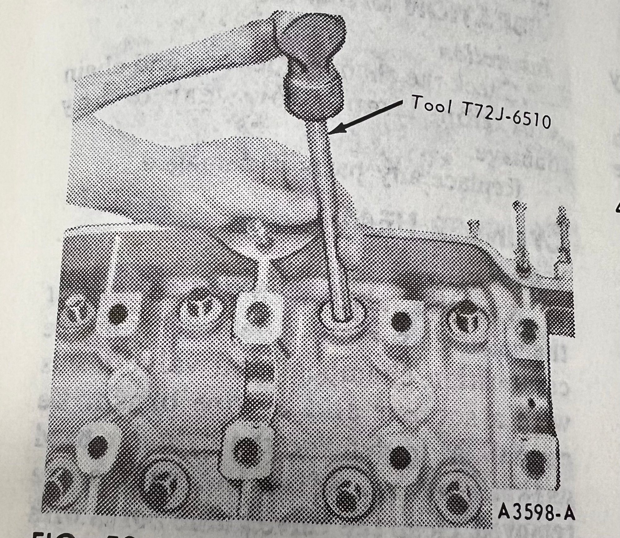

Donor head with about 0.001” warp. We’re good to go there to get a skim cut. I planned to replace the valve guides but wasn’t interested in sourcing this tool.
https://cimg0.ibsrv.net/gimg/www.maz...3d75c627e.jpeg
So I turned some scrap stainless on the old south bend and beat the living hell out of them. Success.
