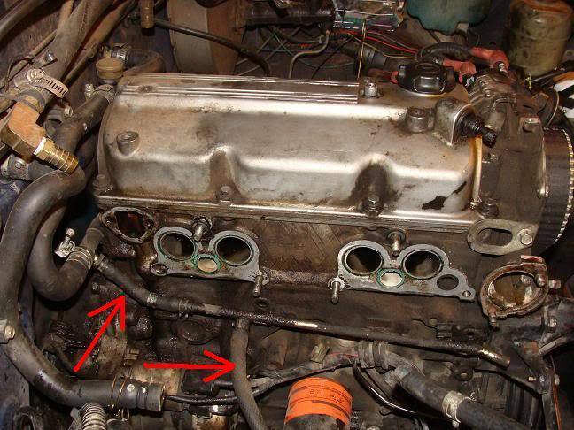

There are three small coolant bypass hoses, two are on the passenger side under the intake manifold, just where you describe the leak. The other is U-shaped and on the front of the engine near the thermostat. So check/replace those (I got mine from the dealer, but part numbers below are good):
8mm i.d. by-pass hose to – underside of Intake Manifold to Pipe on passenger side: Mazda FE87-13-116 $6, or S-shaped Gates 18100 (cut to length, special order O’Reillys), S-shaped Gates 18100 or Gates 28408
10mm i.d. by-pass hose parallel to cylinder head almost-straight hose going toward the /firewall
Mazda FE1H-15-288 $6 or Gates 28409
10mm U-shaped Bypass hose Mazda FE65-15-284B Gates 18206 Dayco 71348

When I rebuilt my B2200 engine in 2011 (smoke) at 183K, I replaced the factory bypass hoses - even though they looked fine for their age/life - with new ones from the dealer, was just so much easier to access the two underneath ones and to do it right, and these were not expensive. Most likely the little metal connecting tube/tee is OK. The factory hose clamps on these I hate, so I replaced them with made-in-USA hose clamps that can be loosened/tightened with a screwdriver or 1/4-inch nutdriver or socket, facing a direction which I could access later if need be. There are photos in my engine rebuild thread MazdaBScene.com - Mazda Truck Owners and Enthusiasts
The front hose is easy to replace anytime.
Also check the two hoses to/from the heater box/firewall.

Thanks again for your advice. I ordered the parts and then while I was waiting for them I decided to look a little deeper. I ended up identifying the problem hose and was able to pull it without taking any of the engine apart. It was the longer one right in the middle of your attached image. It was a pain to get out of there but managed to get it and I replaced it with a chunk of fuel line hose from the auto store. Works great now!
