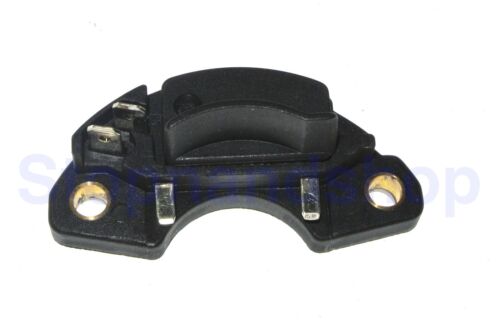

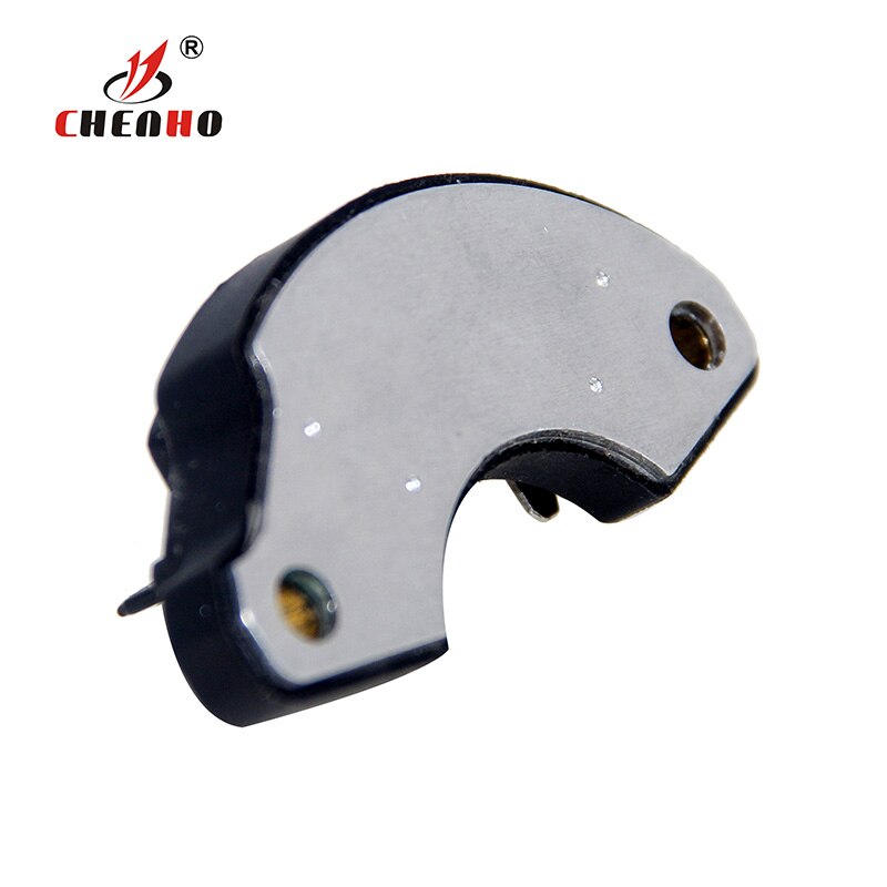

Cleaning up all the connections and grounds has seemed to help with the cranking but I had intermittent cranking but no start issues. Today I had a dental appointment, the B2200 wouldn't start (so I drove my 1998 Frontier). Upon my return, it still wouldn't start, so at least I had opportunity to investigate. I turned on ignition and got 12 volts positive at coil positive terminal, good. Then I set up my spark test light and my remote starter, turned ignition to "run" and cranked the engine: no spark. I even set up my timing light on a spark plug wire and then on the coil wire: no spark. I looked up how to test the coil on the online manual, primary (1.4 ohms) and secondary resistances (8.43 kohms) were within specifications. So I pulled the pickup coil/ignitor from the distributor (I had replaced the internal oil seal a full two years ago), separated the pickup coil from the ignitor and tested the resistance of the pickup coil, again in specification (1000 ohms). I'm not able to test the ignitor part myself, but did notice that its bottom metal surface was coated with clean engine oil. So I wiped that clean, and also wiped clean the corresponding surface inside the distributor.
B2200 starter-s-l500.jpgB2200 starter-new-ignition-control-module-fits-mazda-b2200-truck-ford-probe-mx-6-626-oe.jpg
On a lark I decided to re-assemble everything inside the distributor and then I tried to start it, and it started right up, and started quicker than it has for many months!!! So I wonder if the oil film on the bottom of the ignitor was the cause....anyway, this is the factory distributor at 236K miles, I decided I should order one from Rock Auto and use my existing one as a spare...
