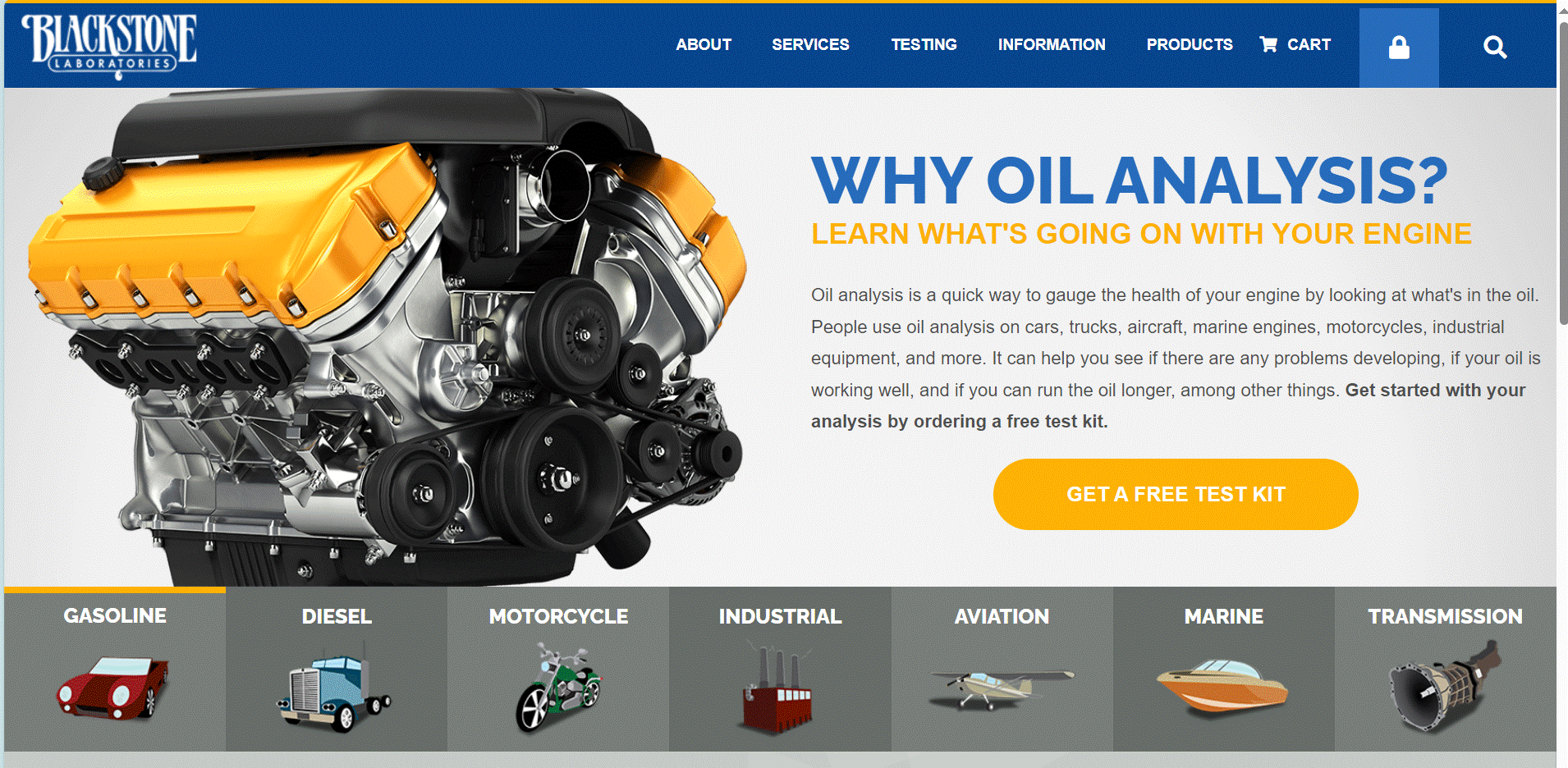

There have been many OIL use reports posted on this and other forums. The one I recommend is
Blackstone Laboratories Blackstone Laboratories (blackstone-labs.com)

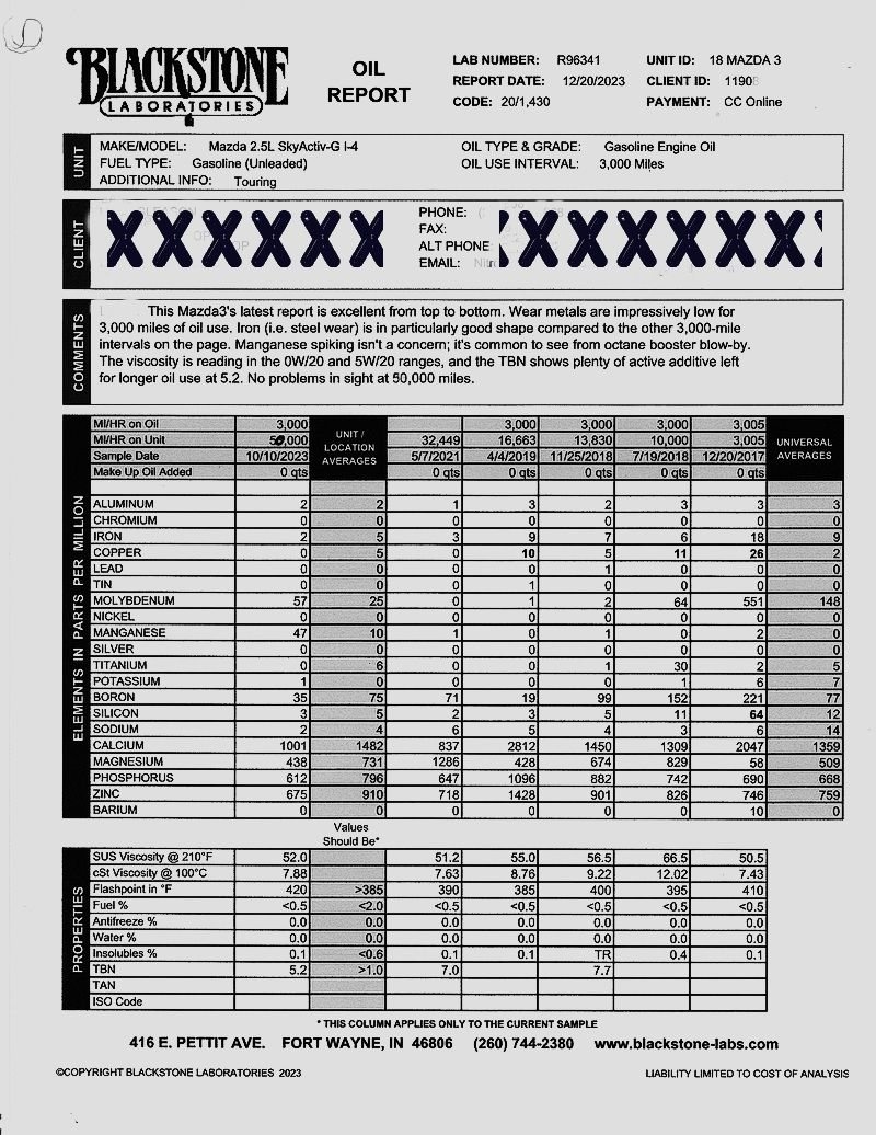

Here is my last report on both Engine and transmission. They also keep a record for comparison of previous oil samples.
