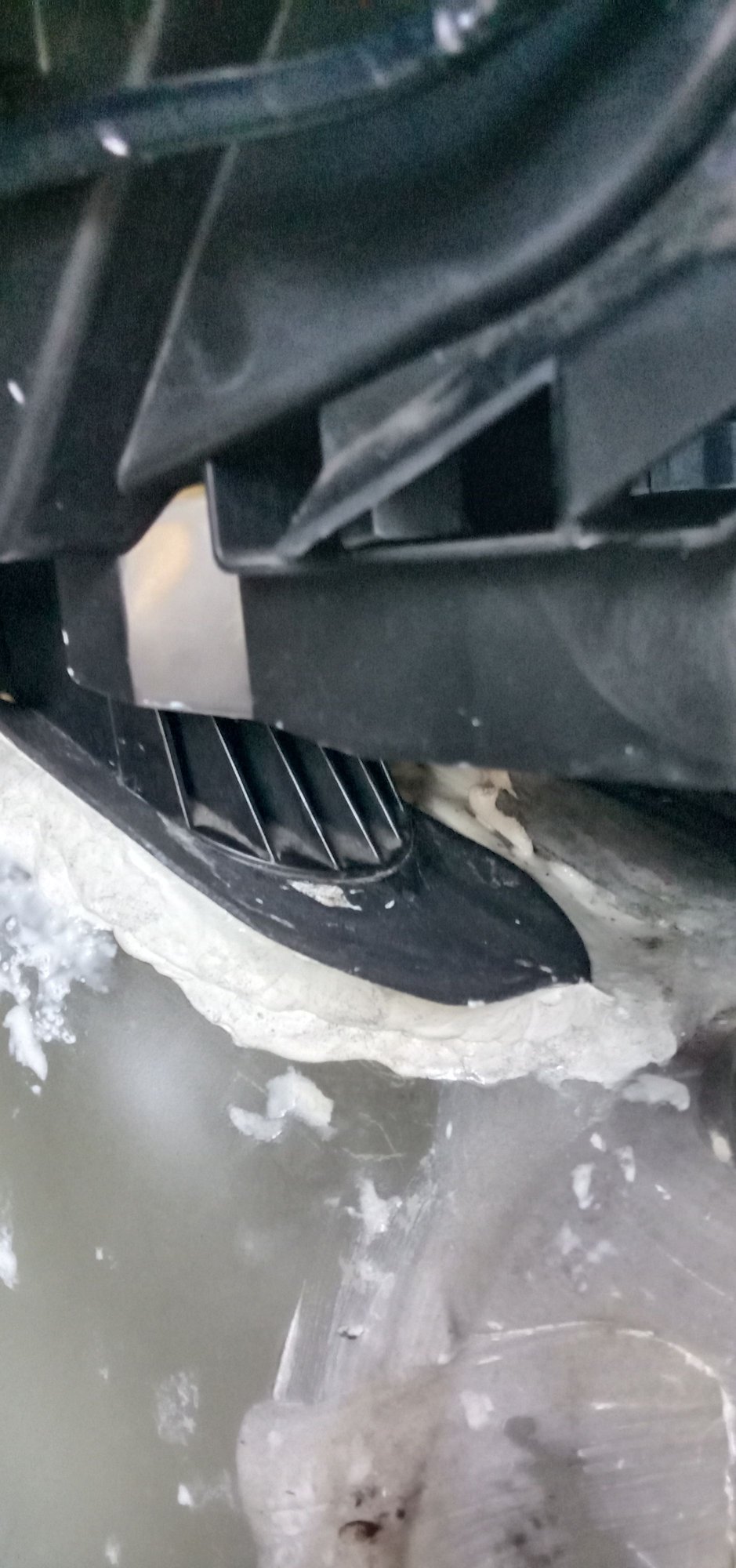

Hi, hope someone can help me.
I have a 2006 Mazda Verisa, and have been getting substantial water in the passenger foot-well.
Finally traced what I think is the source of the leak to water seeping through a sponge-like seal in the object pictured below.
It is in the center of the car under the dashboard. But I don't know what this is, looks like some kind of conduit for something.
It does not look like the seal is supposed to be watertight so I am thinking water is getting in some where under the hood and dripping down to here.
Any idea what this is and where the source of the leak could be?
Thanks

Forgot to mention that the water is clean (ie not coolant) and appears after it has been raining, so pretty sure it is getting in from the outside, rather than from aircon.
Am thinking that rainwater is dripping down from the top of that conduit, so want to know what it is, and where it goes.

Default Plumbers Putty
Hi, I had the same issue with my Mazda Demio. I used plumbers putty to completely seal up the area over the spongy material. I sealed from the solid plastic to the metal and it does the trick.
