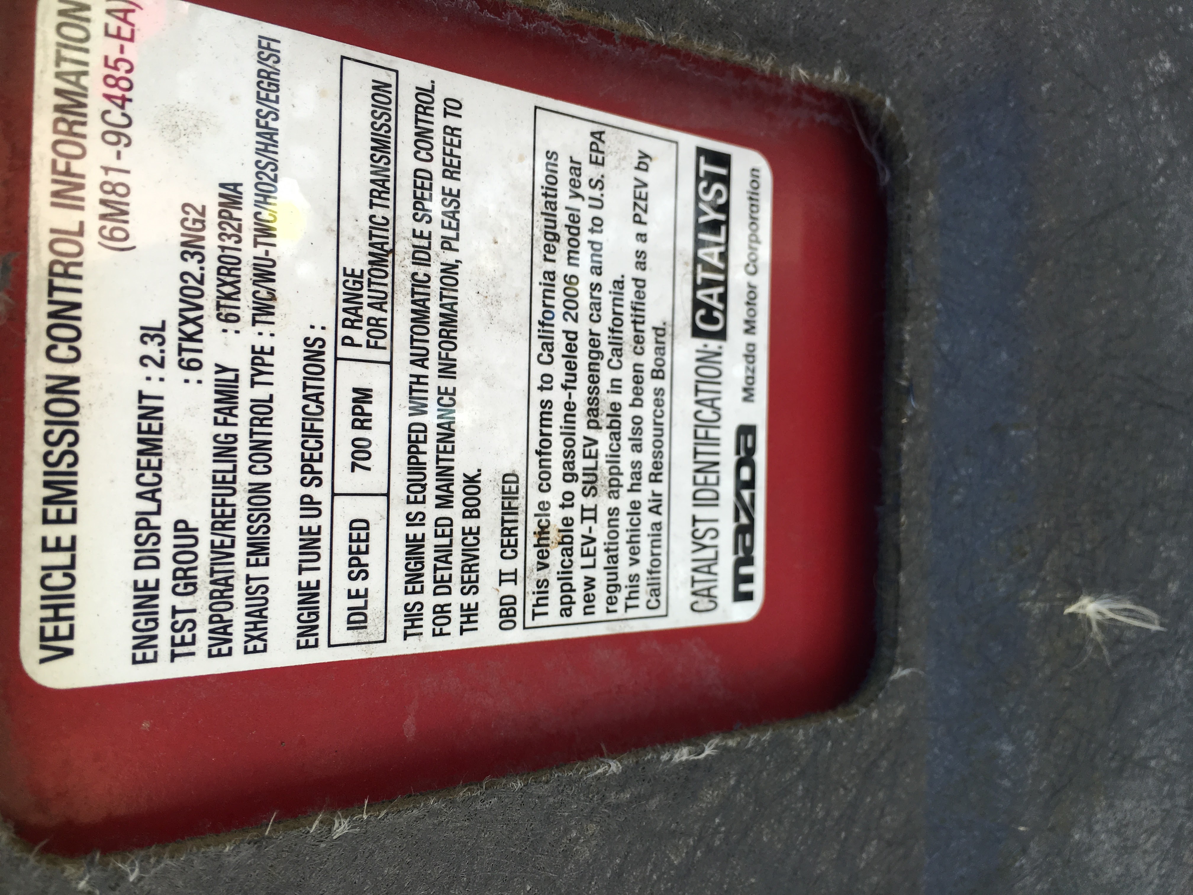

Will this engine from the grey Mazda 6 fit the red 06 mazda 6? Can anyone tell me?

Any 2.3 Mazda 6 engine from late 2005 - early 2008 will fit & do the job. Emissions is all electronic. Just use the manifolds & auxiliaries from your old engine on the new block.
That's my issue this is an 04 Mazda 6 the engine would come out of
Old Dec 18, 2016 | 05:48 AM
Posts: 7,849
any 2.3 motor will fit & run. We've done it before at work. Early 2.3 engines are cheaper than later 2.3's.
