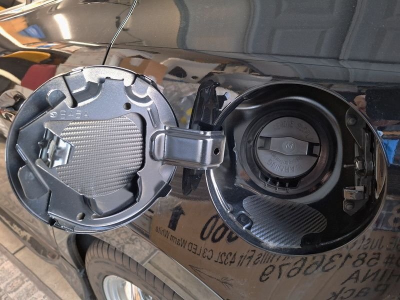

Remove gas cap

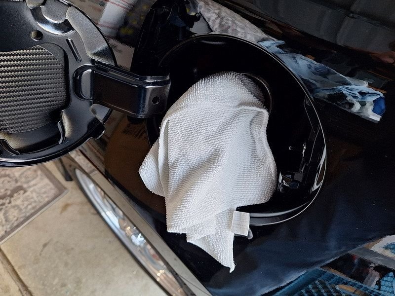

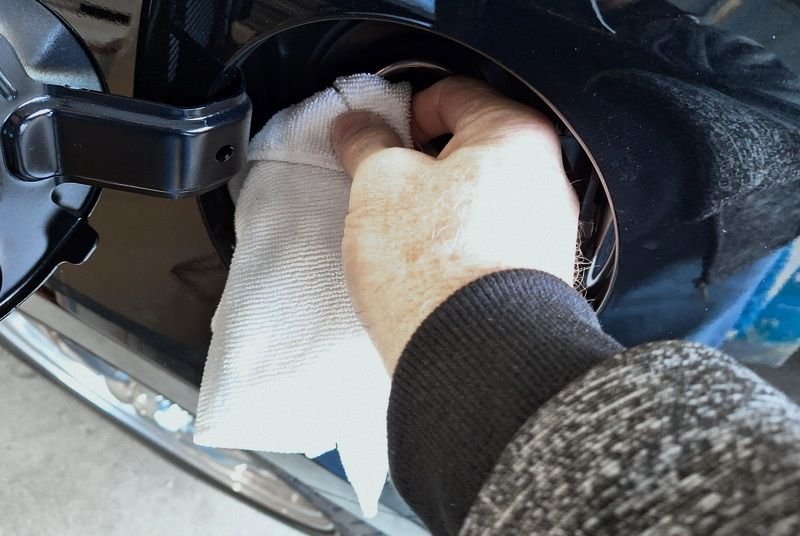

wipe the inside area of filler neck
remove if applicable the oil ring on the gas cap
Useing a new clean rag wipe the inside area of the gas cap. You may need a little WD-40 to help with really dirty areas
Wipe and or replace the O-ring if the oil ring appears to have cracks or will not hold a round shape.
Reinstall oil ring
reinstall gas cap.
Wipe the inside area of the filler neck, gas cap area only after the gas cap has been reinstalled
DONE!

Basic pictures servicing pictures. Many areas will vary slightly depending on the year and model platform.
