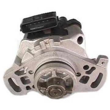

Guys, I have what seems like a really dumb question..
I have a 1995 Protege 1.5. Had the distributor off. Now, how do you know how the distributor fits back onto the camshaft? The distributor has 2 flanges that fit into corresponding slots in the camshaft, similar to the one in the attached picture. OK, but that leaves 2 possible orientations, 180 degrees from each other. How do you know which one is correct? I have the shop manual and I can't seem to find that piece of info anywhere in it! Thanks

It will only fit one way. It is just a bit off center.

Ahhh I see it now. Thanks.
