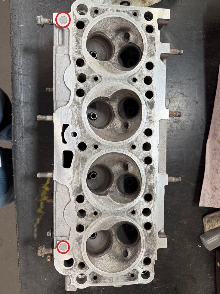

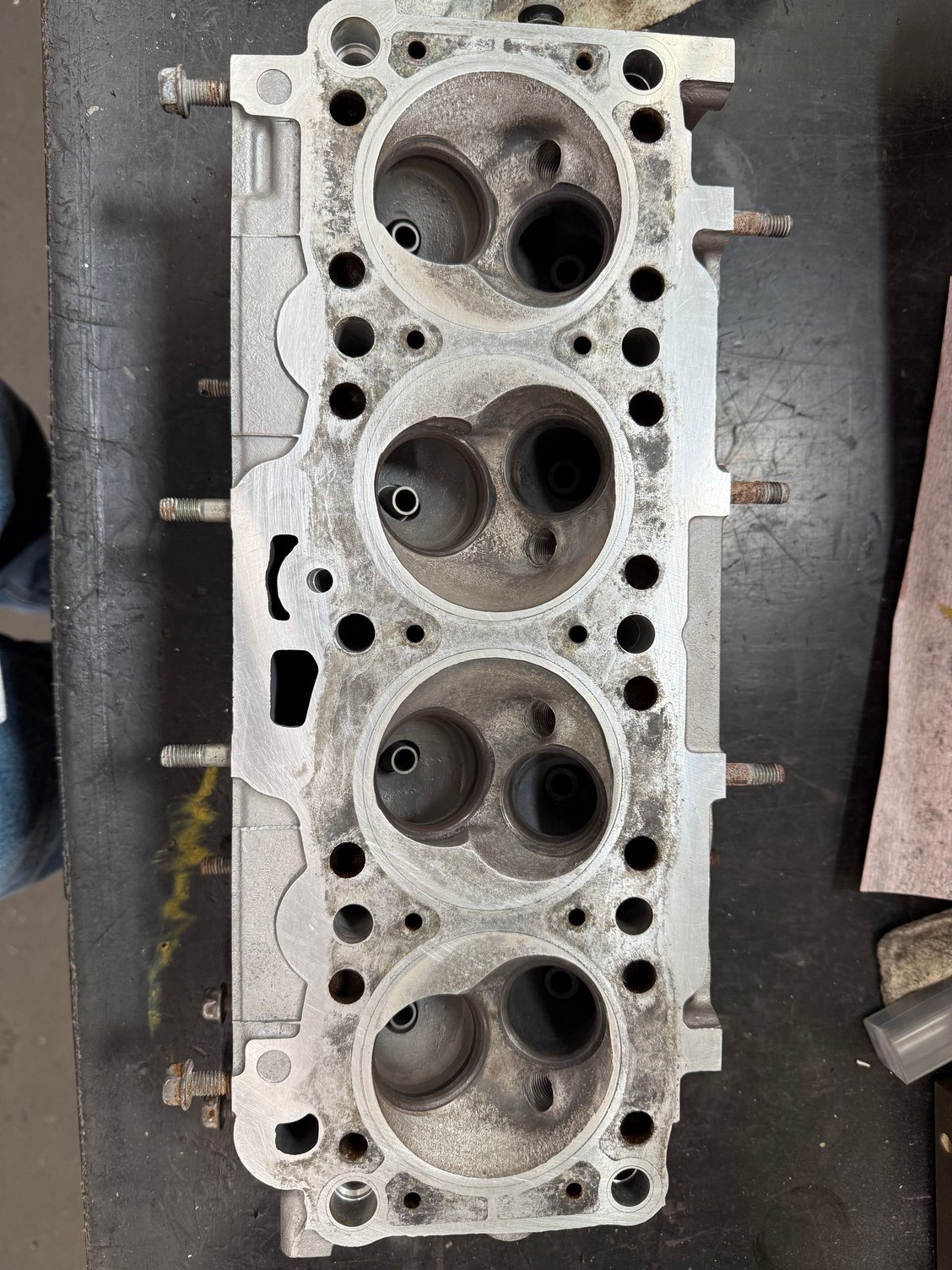

Does anyone know the max amount I can shave off my b2200 cylinder head?
im looking to ad some compression/ HP. Currently im thinking of shaving .020” to .025” off

Typically there are indicators cast into the bottom of the cylinder head to let machinists know if the head has been milled or not. On the Mazda B2200 head those indicators are circled in RED on your cylinder head. As long as these don't disappear during the milling, you should be fine, I would think. That said, the stock B2200 engine is a non-interference engine, milling the head may change that somewhat, depending on how much is milled off.
Also, higher compression is not really going to help the 8-valve head breathe any better. What will help it is to have your stock camshaft re-ground by Delta Camshaft or a similar company.....and adding a Weber and exhaust header will improve it even more.
Are you taking the cylinder head into a machine shop to have the head milled?
Here is the pic of your head with those indicators circled in RED.
